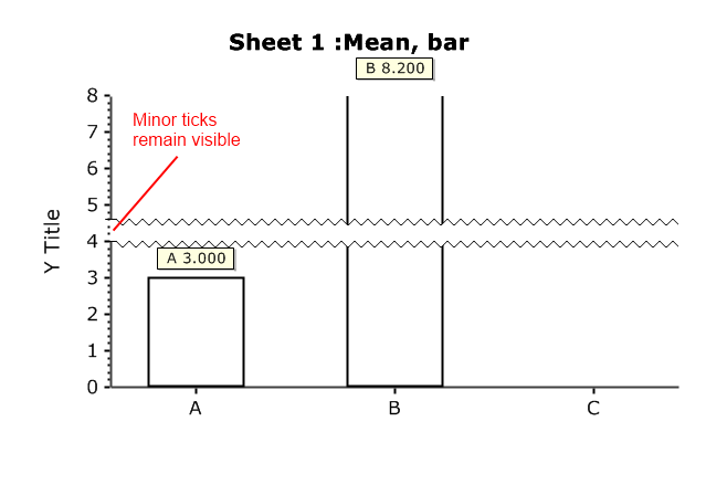

Secondly, minor ticks are drawn between the gap of the breaks. Just a minor thing, but is it possible to fix it in the next release?
I don't think this has ever worked. I added your request to the wish-list (TF02016324) to be considered for inclusion in future releases. If you remember this working in the past it would be very helpful if you could post the version number where this worked.

For the minor ticks in the gap, I have never tested it earlier. I do not know if an earlier version removes the minor ticks in the gap...but thanks for considering it for the future release.

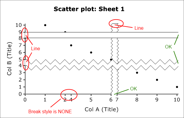

However, during testing I found a few other issues in the appearance of the breaks. It is just minor and an "extreme" case with multiple breaks (unlikely that a user makes a chart like this), but may be it can be resolved in a future release.

I've reproduced the behaviour with the code below so I've added this to the wish list too (TF02016339).
            tChart1.Header.Visible = false;
            tChart1.Walls.Visible = false;
            Points points1 = new Points(tChart1.Chart);
            points1.Pointer.Style = PointerStyles.Circle;
            for (int i = 0; i < 10; i++)
                points1.Add(10 - i);
            tChart1.Axes.Bottom.Grid.Visible = false;
            tChart1.Axes.Bottom.Increment = 1;
            tChart1.Axes.Bottom.MinorTicks.Visible = false;
            tChart1.Axes.Left.Grid.Visible = false;
            tChart1.Axes.Left.Increment = 1;
            tChart1.Axes.Left.MinorTicks.Visible = false;
            Steema.TeeChart.Tools.AxisBreaksTool Xaxisbreaks = new Steema.TeeChart.Tools.AxisBreaksTool(tChart1.Chart);
            Xaxisbreaks.Axis = tChart1.Axes.Bottom;
            Xaxisbreaks.GapSize = 20;
            Steema.TeeChart.Tools.AxisBreaksTool Yaxisbreaks = new Steema.TeeChart.Tools.AxisBreaksTool(tChart1.Chart);
            Yaxisbreaks.Axis = tChart1.Axes.Left;
            Yaxisbreaks.GapSize = 20;
            Steema.TeeChart.Tools.AxisBreak xBreak1 = new Steema.TeeChart.Tools.AxisBreak(Xaxisbreaks);
            xBreak1.StartValue = 2;
            xBreak1.EndValue = 4;
            xBreak1.Style = AxisBreakStyle.None;
            Steema.TeeChart.Tools.AxisBreak xBreak2 = new Steema.TeeChart.Tools.AxisBreak(Xaxisbreaks);
            xBreak2.StartValue = 6;
            xBreak2.EndValue = 7;
            Steema.TeeChart.Tools.AxisBreak yBreak1 = new Steema.TeeChart.Tools.AxisBreak(Yaxisbreaks);
            yBreak1.StartValue = 4;
            yBreak1.EndValue = 5;
            Steema.TeeChart.Tools.AxisBreak yBreak2 = new Steema.TeeChart.Tools.AxisBreak(Yaxisbreaks);
            yBreak2.StartValue = 8;
            yBreak2.EndValue = 9;
            yBreak2.Style = AxisBreakStyle.Line;
I've seen that hiding the axes pen makes some of the undesired lines to disappear, but if you want the axes to be drawn, then you'll have to draw them manually...
