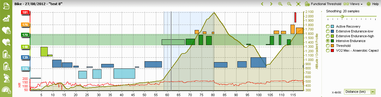

In the attached screenshot there are TAreaSeries with custom vertical axes created at runtime.
Before I (re)create the series, I destroy the series as in code below.
The problem is that this takes quite some time where I see the hour glass flicker for each series that is destroyed.
Is there a way to avoid this ?

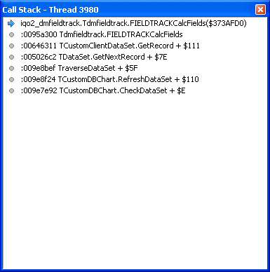

However, when I debug on the line Series.Free I get the call stack as in the attached file.
The series I am destroying is not linked to a datasource though, the points are just added manually.
Edit: when i create the series and populate them, it's instantaneous, the delay and flicker only occurs when destroying.
It seems the data for other series linked to a datasource on the same chart is being refreshed for some reason ?
I tried setting all chart series to Active=False, but seems the problem remains.
