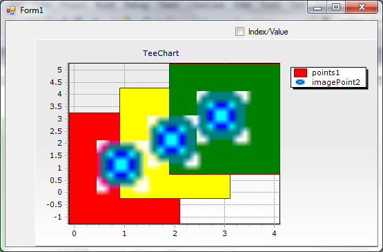

But thanks for your recent sample; that helped me to narrow down to the issue. The actual problem is, the image displayed by the ImagePoint series doesn't fill up the pointer's HorizSize and VertSize completely. Because of that we are not able to see the overlap properly and hence misguided that there is no overlap.
Please check the code below:
			tChart1.Width = 500;
            tChart1.Height = 300;
			Points points1 = new Points(tChart1.Chart);
			points1.Add(1, 1, Color.Red);
			points1.Add(2, 2, Color.Yellow);
			points1.Add(3, 3, Color.Green);
			points1.Pointer.HorizSize = 80;
			points1.Pointer.VertSize = 80;
			ImagePoint points = new ImagePoint(tChart1.Chart);
			points.Add(1, 1, Color.Red);
			points.Add(2, 2, Color.Yellow);
			points.Add(3, 3, Color.Green);
			points.Pointer.HorizSize = 80;
			points.Pointer.VertSize = 80;
            points.ClickPointer  += new CustomPoint.ClickPointerEventHandler(points_ClickPointer);
            tChart1.ClickSeries  += new Steema.TeeChart.TChart.SeriesEventHandler(tChart1_ClickSeries);
        void tChart1_ClickSeries(object sender, Series s, int valueIndex,   MouseEventArgs e)
      MessageBox.Show(valueIndex.ToString());
        void points_ClickPointer(CustomPoint series, int valueIndex, int x, int y)
Here is the output:
Output
Here I'm adding both Points and ImagePoint series with same values and pointer size. But you can see that the Points series fills the whole 80px. But the image displayed in ImagePoint is displayed only in the center. This misguides the user that there is no overlap between the pointers of ImagePoint series; but actually there is an overlap which we are not able to identify.
Is there any property which says if the image should stretch completely, or a margin, or a padding setting which determines the displayed image size (not the actual pointer size) ?
I hope you are able to understand my question.
In this point you are right,because at the moment doesn't exist any property that allow you modify the style of image point. For this reason, we add this request in feature request number [TF02016482] to be consider its inclusion in upcoming releases of TeeChartFor.Net.
