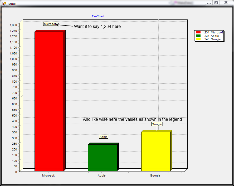

I'm trying to programmatically show a Bar series where the Y value of the bar is the amount, the text under each bar (bottom axis) is the Organisation Name and at the top of each bar display the actual Y value.

As it is above it displays the YValue at the top of each bar but the text on the bottom axis under each bar appears to be just some ordinal value starting at 0.
If I uncomment the LabelMember line above then I get the Organisation Name under each bar on the bottom axis but then it also shows it as the value above each bar.

Okay is a simply example VS2010 app that uses TeeChart v2 and targets .NET 2.0.
I've also attached a screenshot of the this test app with indicators of what I am trying to achieve.
Peter
Screenshot with text on to indicator what I want.

Thanks for that :D . A bit of crossed wires between my first post description and the example as I want all the bars to have the value shown as the label.
So in fact the required code is as simple as adding:
barSeries.Marks.Style = MarksStyles.Value;
Anyhow your posted code was great as I might need to add some formatting and hence add a handler to set the text as you had in your example.
