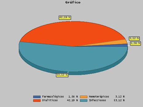

I'm getting a few problems to get the percentage of the pie graph to 100%.
I use it to show the percentage of the values from query of the database.
The query returns integer values like:
34
27
1
2
Doing the math, we can get the follow percentage of each:
34 - 53,125%
27 - 42,1875%
1 - 1,5625%
2 - 3.125%
The pie just show 2 decimals (which is ok, because the default mask uses ##0.## '%' and i think that 2 decimals is ok.
But the result, you can see in the image below attached, doesn't sum the 100%, it always get 99,99%.

Pie with 99%
Sorry about the wrong image before

Right, this is a rounding problem. Since the PercentFormat is specified to have a limited number of decimals, there will always be set of values that will end in a non 100 % sum.
In some cases, adding some more decimals will be enough:
series.setPercentFormat("##0.### '%'");
However, in some other cases, the rounding conflict will be in a too far decimal number (to be shown in a easy to read text). Or even you can have periodic numbers. Ie, you can have the values 33, 33, 33. They sum 99, and their percentage is for both them 33.3333... Which one of the three texts should be rounded?
We'd better let our customers decide it. You can always use the LegendResolver and MarkTextResolver to manually calculate the percentages and decide where to apply any rounding.
