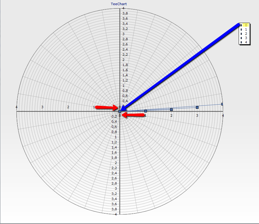

Complementing Sandra's answer, I don't think this is a bug but normal TeeChart behavior. Actually, zero is in the center but labels are shifted from the axes as done with all other labels. A picture is worth a thousand words:
As shown here, each "0" label overlaps the pen of a neighbor axis. It's not that "0" labels in that axis are not referring to the center of the chart.
If the explanation is not clear please let me know.

thanks, Sandra and Narcis,
the picture is very similar to what i was seeing. so, most likely the center of my chart is also 0.
