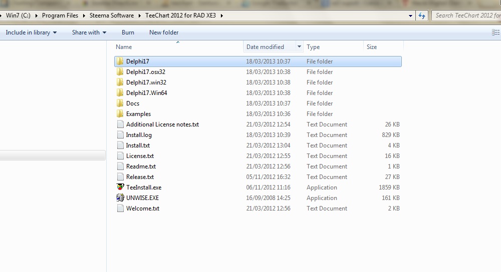

First, I inform you that the TeeChartVCL (v2012.07.121105) included x32 and x64 bits. I check it here and appears x64 bits as you can see in next image:
Why is it looking for version 8.08 code?
