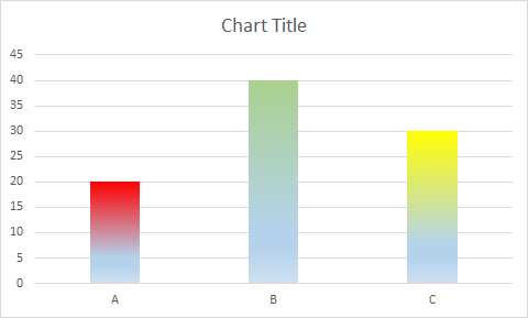

In that post I asked for the opposite; the same gradient for all bars.
Now I'm asking for different gradients for different bars (obviously in the same Bar class instance). Please see attached image.

In the mentioned reply, where we are trying to set a gradient relative to an "external" maximum. This sounds as having the same gradient, but the solution suggested actually modifies the 2 of the 3 colors of the canvas gradient each time a bar is going to be drawn. So that solution should be flexible enough to cover any desired gradient.
Another, maybe simpler, solution for this case, would be to add a Bar series for each gradient type you want to show. In the image you've attached, you could have 3 Bar series with a value for each one. Then, you could set your gradient for each series. Just note that with this solution you'll have to add the values with XValue, otherwise, having three Bars with just a value will end on three values at XValue=0.

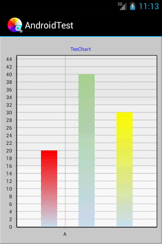

I meant you could create 3 instances of the Bar series class (bar1, bar2, bar3), define the gradients of each them, and add a unique point for each. Something like this:
		Bar bar1 = new Bar(tChart1.getChart());
		bar1.getPen().setVisible(false);
		bar1.getMarks().setVisible(false);
		bar1.getGradient().setVisible(true);
		bar1.getGradient().setUseMiddle(false);
		bar1.getGradient().setEndColor(Color.fromArgb(205, 224, 242));
		bar1.getGradient().setStartColor(Color.red);
		Bar bar2 = new Bar(tChart1.getChart());
		bar2.getPen().setVisible(false);
		bar2.getMarks().setVisible(false);
		bar2.getGradient().setVisible(true);
		bar2.getGradient().setUseMiddle(false);
		bar2.getGradient().setEndColor(Color.fromArgb(205, 224, 242));
		bar2.getGradient().setStartColor(Color.fromArgb(170, 210, 145));
		Bar bar3 = new Bar(tChart1.getChart());
		bar3.getPen().setVisible(false);
		bar3.getMarks().setVisible(false);
		bar3.getGradient().setVisible(true);
		bar3.getGradient().setUseMiddle(false);
		bar3.getGradient().setEndColor(Color.fromArgb(205, 224, 242));
		bar3.getGradient().setStartColor(Color.yellow);
		bar1.add(0, 20, "A");
		bar2.add(1, 40, "B");
		bar3.add(2, 30, "C");
This would let you define the colors without having to handle any event. But we have then a problem with the bottom axis labels:

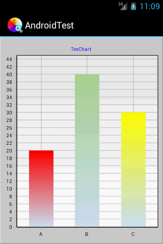

So I'd better rectify my suggestion: I'd continue using a unique Bar series with three points in it, and using the BarStyleResolver event to modify the gradients:
		bar1.add(20, "A", Color.red);
		bar1.add(40, "B", Color.fromArgb(170, 210, 145));
		bar1.add(30, "C", Color.yellow);
		bar1.setBarStyleResolver(new BarStyleResolver() {
			@Override
			public BarStyle getStyle(ISeries series, int valueIndex, BarStyle style) {
				if (series!=null) {
		               if (valueIndex > -1) {
		            	   tChart1.getGraphics3D().getGradient().setStartColor(series.getValueColor(valueIndex));
				return style;
		tChart1.getAxes().getLeft().setMinMax(0, 45);
