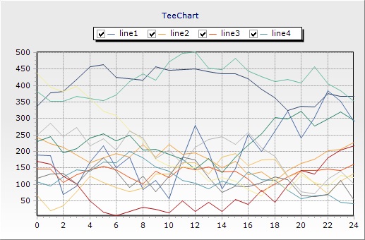

Back to the issue, I'm not able to reproduce it with v2013 and this code:
      InitializeChart();
      tChart1.Legend.Alignment = Steema.TeeChart.LegendAlignments.Top;
      tChart1.Legend.MaxNumRows = 1;
      tChart1.Legend.CheckBoxes = true;
      for (int i = 0; i < 12; i++)
        tChart1.Series.Add(new Steema.TeeChart.Styles.Line()).FillSampleValues();
which produces this chart:
Can you reproduce the problem with this code? If not, can you please modify it so that we can try to reproduce the problem here?
