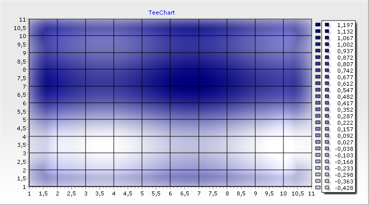

You can use the TChart1.Legend.LastValue as last index for the legend items. Here it is an example:
Private Sub Form_Load()
  TChart1.Aspect.View3D = False
  TChart1.AddSeries scColorGrid
  TChart1.Series(0).FillSampleValues
End Sub
Private Sub TChart1_OnAfterDraw()
  Dim tmpTop, tmpLeft As Integer
  tmpTop = TChart1.Legend.Top + 5
  tmpLeft = TChart1.Legend.Left - 12
  Dim i As Integer
  For i = 0 To TChart1.Legend.LastValue
    With TChart1.Canvas
      .Brush.Style = bsSolid
      .Brush.Color = TChart1.Series(0).LegendItemColor(i)
      .Rectangle tmpLeft, tmpTop + (i * 13), tmpLeft + 10, tmpTop + (i * 13) + 7
    End With
  Next i
End Sub
As you'll see in the image below, I've drawn the rectangles with the symbol colors, next to the symbols.
