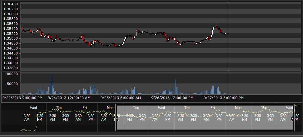

I am trying to make a 15 minutes candle chart that cover multiple weeks of data and insert some axis break to hide empty spaces over weekends.
When i do this, the chart seems good at first but if I try to zoom in or pan it,the chart becomes corrupted and starts drawing series incorrectly.
Moving the chart or zooming it, peaces of series start to disappear and reappear during the mouse action, also sometime a series draw until a break and then continue drawing from the break backward.
Here is some picture to show what i mean:
Chart Look good at start:

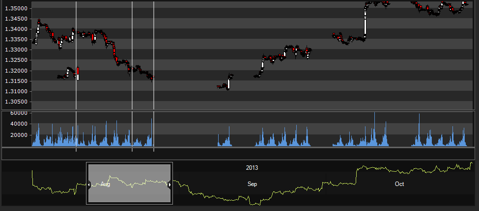

panning a bit on the left a piece of series disappear:
zooming the chart and panning a bit, the series disappear in many points and in some point it draw backward:
