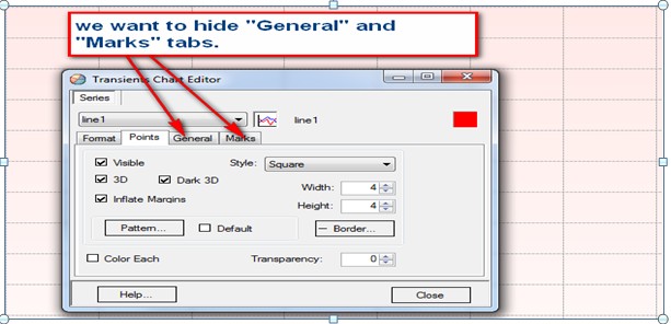

Thanks for the reply. I have displayed only Series tab, in this tab I want to hide “General Tab” and “Marks Tab”.

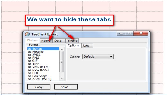

And we have used Show Export Dialog, in this dialog I want to hide “Native” and “Theme” tabs.
tChart1.Export.ShowExportDialog();

Hello Amol,
But I'm afraid it doesn't allow to hide its tabs. It has still added it to the wish list with number [TF0201513] to be implemented in future releases of TeeChartFor.Net. The only alternative is, if you have source code, implement a solution where allow you access to sub editors an select the tabs as you want.
