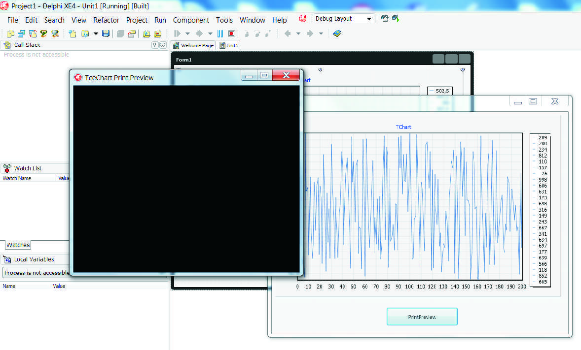

But..... I got another problem. The preview window opens with all black (see the print screen).
Your suggestion didn´t work.

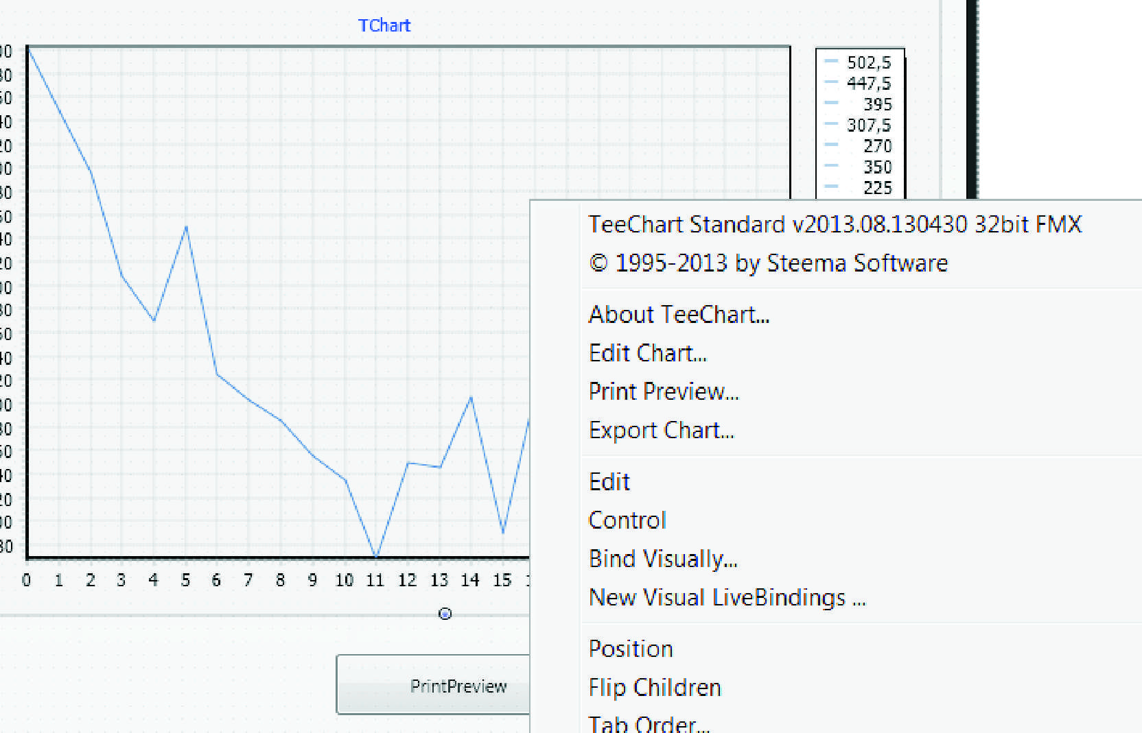

Are you sure you are using the Standard version? This doesn't work for me.

Could you please arrange a simple example project we can run as is to reproduce the black dialog in the picture?
