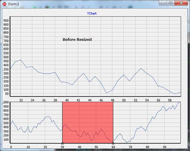

Post by elmec » Tue Dec 03, 2013 3:54 am
Before Resized
Project2.zip
Exe file
(87.93 KiB) Downloaded 935 times

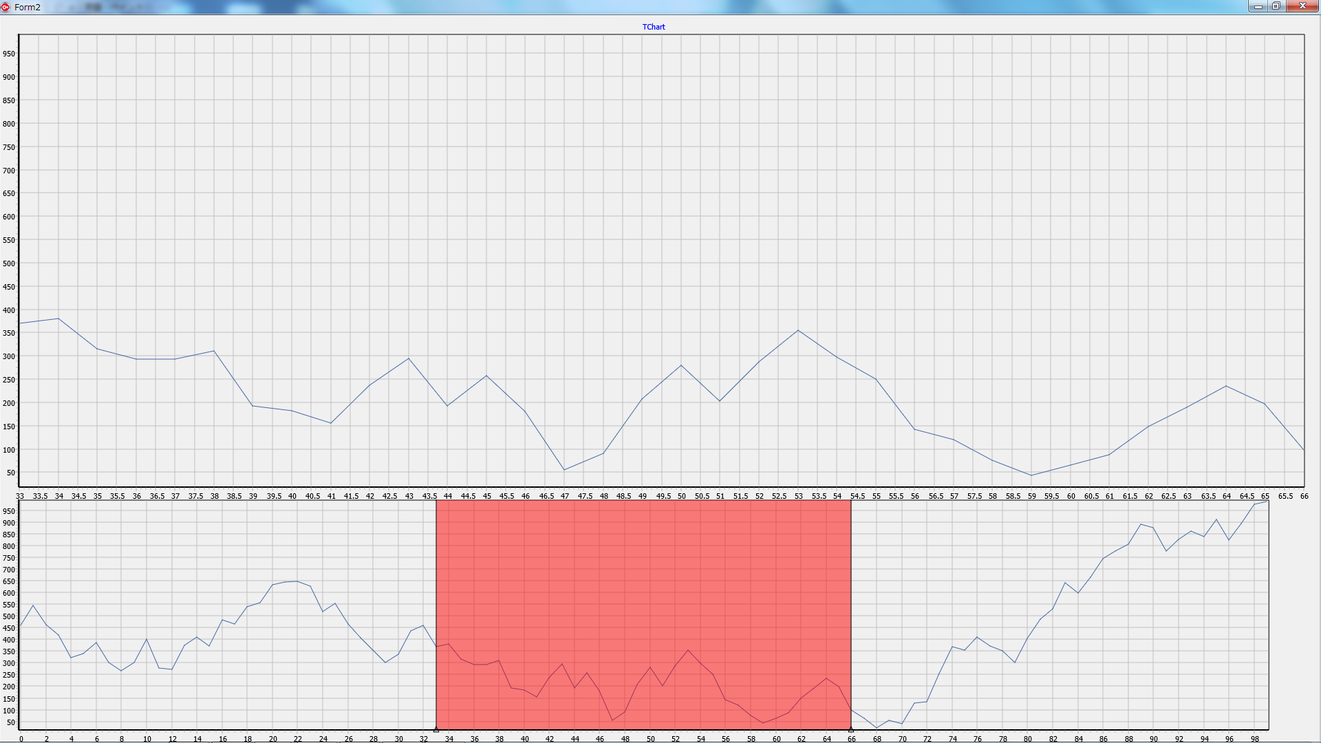

Please follow the following steps to reproduce the issue.
1). Change the StartValue and EndValue of TScrollPagerTool to the value instead of default,
2). Resize the TChart.
3). Click on the TChart.
I think you missed the step 1...

I have 3 PCs, all of which can reproduce the problem.
They are Panasonic CF-B11(64Bit), DELL Dimension E521(32Bit) and DELL Vostro 260(32Bit).
so I don't think there are any particular combination..
I will attach the Exe file, would you please try it again using it,
NOT using the recompiled one.
Anyway, I will attach the video again to make the steps clearly..
The file is too big, so I upload them here.
https://skydrive.live.com/redir?resid=5 ... ADC%21212
