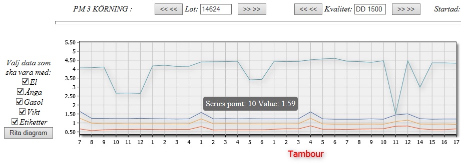

I´m working with charts from tables like :
Chart1.fromTable('2',Tee.Line,'True',0,0);
Using dates as label values, the are long, so I would like to rotate them 90 degr. Can´t work this out.
Have tried with different codes like:
Chart2.axes.bottom.labelvalues.rotation = (90:0) ;
Also have some truble with the tip tool.
tip.ongettext = function(tool, text, series, index) {
  var s = 'Series point: ' + index.toFixed(0) + '\nValue: ' + series.data.values[index].toFixed(2);
  return s;
I want to show the labelvalue instead of the index as Series point.
Best would be to show a Timestamp, that is a second labelvalue incerted in the table, within the tip frame. Can I work with dubble x-values like this ? If so; how ?
My grateful regards
TG
Diagram with object id used as labelvalue.

Try this:
Chart1.axes.bottom.labels.rotation=90;
E-portal wrote:Also have some truble with the tip tool.
  return s;
Try with series.data.labels[index] instead of index.toFixed(0):
    var s = 'Series point: ' + series.data.labels[index] + '\nValue: ' + series.data.values[index].toFixed(2);
    return s;
