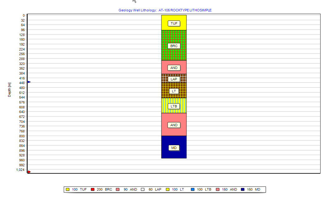

I have made some progress with the stacked bar chart. I use two procedures, firstly InsertGeologicalSeries which puts the data queried from the database in a memory table, and calculates depth increments. The program then creates a unit bar series and links the DataSource to the memory table. TUnitBarSeries.DrawBar overrides Series.TBarSeries.DrawBar.
I am now able to colour the foreground and background, but I am unable to draw a legend apart from one showing the Name of the TUnitBarSeries and a random colour. (see attachment). I have searched the entire TeeChart Help and am unable to find out how to do this. Any suggestions welcome.

Errol wrote:I am unable to draw a legend apart from one showing the Name of the TUnitBarSeries and a random colour. (see attachment).
I'm not sure about how you'd like the legend to be. According to your previous post:
Errol wrote: 2. Legend. Rocktypes are repeated but I want only one instance of each rocktype in the legend (and preferably in alphabetical order). Is there any easy way to do this (remember I am sending a BarSeries to the chart, not drawing the chart record by record.
So I assume you'd like to have all values in the series being represented in the legend. You can do that using default legend style:
  Chart1.Legend.LegendStyle:=lsAuto;
Or force that setting it like this:
  Chart1.Legend.LegendStyle:=lsValues;

Thank you for your suggestion. I set LegendStyles to lsValues and sure enough I obtained a legend (see attachment). However, there are a couple of issues:
1. The legend symbols show only the foreground colour of the corresponding bar, not the whole pattern. Can the symbol be modified to duplicate the bar pattern, foreground and background? I draw the pattern by using ColorSource, Brush.Style and Vrush.Color.
2. The legend text gives both the incremental depth and the Rock Type Code. I see that XLabelsSource controls the text field (in this case Rock Type Code). How do I suppress the incremental depth value?
3. Can I turn individual items of the legend on and off?
Thanks in advance
In that case I recommend you to use the legend Picture property as explained here. Notice this is included with the version we published earlier today. This might not be suitable for different symbol pictures in a single series, in which case you could do as in the All Features\Welcome!\Miscellaneous\Legend\Symbol OnDraw example in the new features demo, available at TeeChart's program group.
You can either set the LegendStyle property or use the OnGetLegendText event to parse and remove it or Chart1.Legend.Items list as in the All Features\Welcome!\Miscellaneous\Legend\Items property.
This can only be done with legend checkboxes or using the ShowInLegend property with multiple series.
