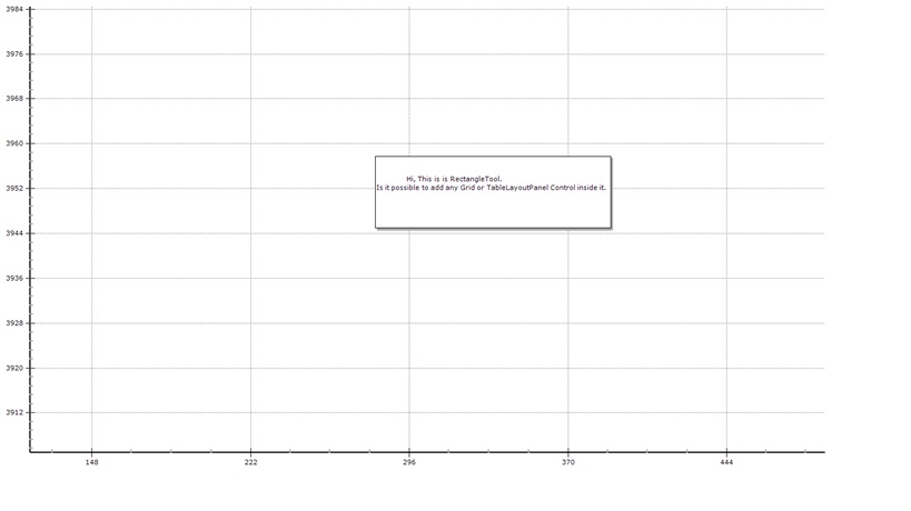

Hi Steema Support,
Is it possible to add data grid view (dot net control) or any table layout control, we can add in teechart Rectangle tool as shown in fig. below
It will so helpful for us if you please provide any alternative solution.
Thanks and Regards
Planoresearch

Amol,
Apologies in the delay in replying. Yesterday was a holiday here.
Yes, you could think of deriving your own class, e.g.
  public class MyRectangleTool : RectangleTool
    public MyRectangleTool() : this((Chart)null)
    public MyRectangleTool(Chart c)
      : base(c)
      DataGridView = new DataGridView();
      IChart parent = c.Parent;
      if (parent != null)
        Control control = parent.GetControl();
        control.Controls.Add(DataGridView);
    public DataGridView DataGridView
      get;
      set;
    protected override void ChartEvent(EventArgs e)
      base.ChartEvent(e);
      if (e is BeforeDrawEventArgs)
        Rectangle newBounds = Bounds;
        newBounds.Inflate(-10, -10);
        DataGridView.Bounds = newBounds;
    protected override void OnResizing(EventArgs e)
      base.OnResizing(e);
and then using it in your chart, e.g.
      line.FillSampleValues();
      MyRectangleTool tool = new MyRectangleTool(tChart1.Chart);
      tool.Shape.Transparency = 0;
      tool.Width = 100;
      tool.Left = 100;
      tool.Top = 100;
