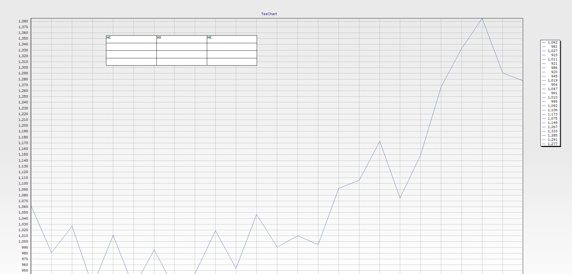

Hi Steema Support,
Can you write data in each row? We are using this g.TextOut(i, rect.Top, rect.Bottom - 1, "HI"); to write but this method write only one row not all. Image is attached
for (int i = rect.Left; i < rect.Right; i += horizIncrement)
g.VerticalLine(i, rect.Top, rect.Bottom - 1);

Re: Grid in Rectangle tool
Post by Christopher » Tue Nov 25, 2014 9:59 am
Amol wrote:Can you write data in each row?
This is a basic programming task which is not TeeChart API specific. You could do something like this:
    protected override void ChartEvent(EventArgs e)
      base.ChartEvent(e);
      if (e is AfterDrawEventArgs)
        DrawGrid(Chart.Graphics3D, Bounds);
        DrawCells(Chart.Graphics3D, Bounds);
    private void DrawCells(Graphics3D g, Rectangle rect)
      int horizIncrement = Utils.Round((double)rect.Width / numCols);
      int vertIncrement = Utils.Round((double)rect.Height / numRows);
      for (int i = rect.Left; i < rect.Right - 1; i += horizIncrement)
        for (int j = rect.Top; j < rect.Bottom; j += vertIncrement)
          g.TextOut(i, j, "BYE");

Hi Steema,
Thanks for your reply, We want to set the column size according to the text written in that column. Suppose first column have text of 100 character and second column column contains 10 character the column size should be accordingly. and can we wrap the text written in it.We are waiting for your response.
Post by Christopher » Tue Nov 25, 2014 11:06 am
Amol wrote: Thanks for your reply, We want to set the column size according to the text written in that column. Suppose first column have text of 100 character and second column column contains 10 character the column size should be accordingly. We are waiting for your response.
You can use the Graphics3D.TextWidth() method to measure the length of strings, e.g.
float width = g.TextWidth("BYE");
