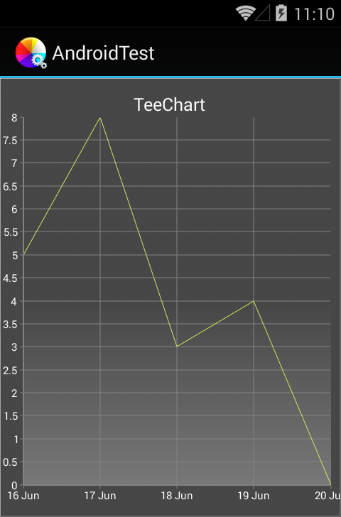

Hello Saman,
This is how it looks for me. How does it look for you?

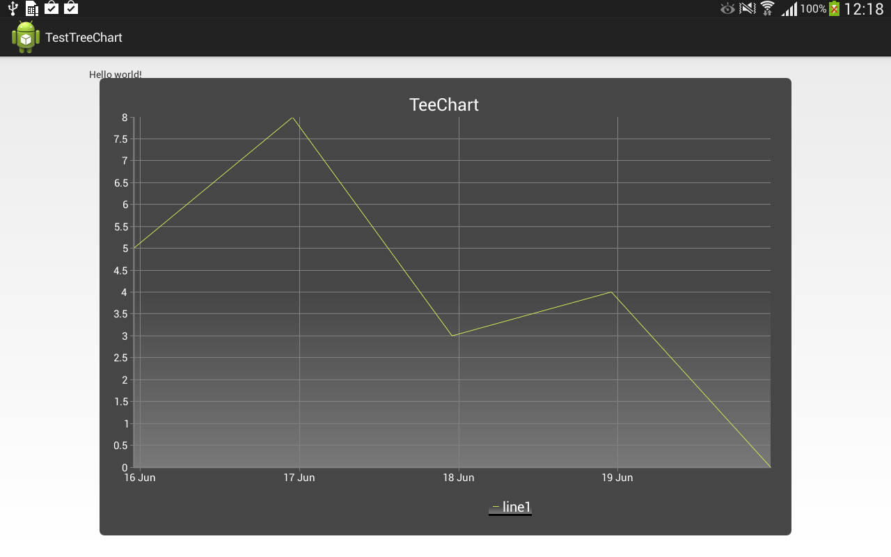

Post by Saman » Wed May 21, 2014 11:32 am
This is what I get (also please note that I am in UK different time zone)
I have attached the photo
