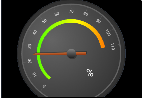

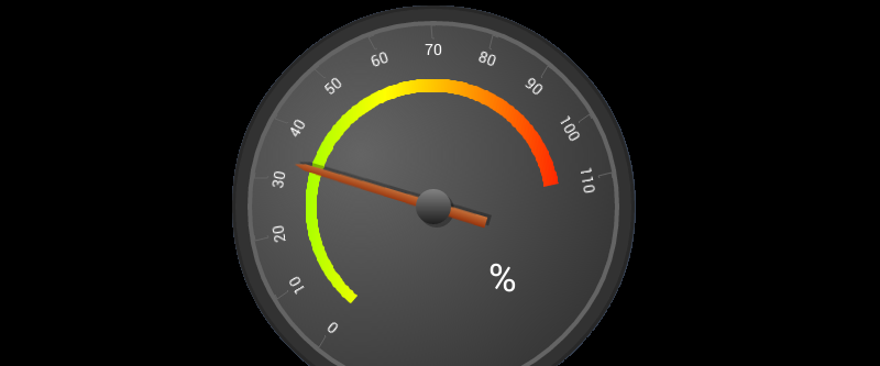

Here is an example of what I said about the differences at the gradient color.
The images show how the gradient looks at the landscape and portrait view.
Following is the main code I have used to setup the gradient.
circularGauge1.setGreenLineStartValue(0.0);
circularGauge1.setGreenLineEndValue(110.0);
circularGauge1.getRedLine().setVisible(false);
circularGauge1.getGreenLine().getGradient().setDirection(GradientDirection.BACKDIAGONAL);
circularGauge1.getGreenLine().getGradient().setUseMiddle(true);
circularGauge1.getGreenLine().getGradient().setStartColor(Color.green);
circularGauge1.getGreenLine().getGradient().setMiddleColor(Color.yellow);
circularGauge1.getGreenLine().getGradient().setEndColor(Color.red);
BR,
E.
Re: Android CircularGauge green line color affects ticks color
Post by Yeray » Thu May 29, 2014 12:00 pm
You may be interested on reading the discussion here, where the limitations on the gradients in CircularGauges are exposed.
