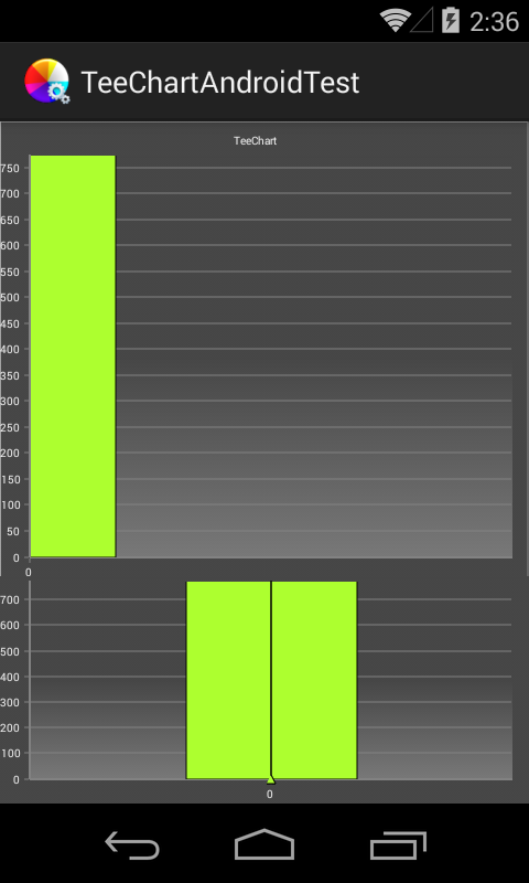

This is how it looks for me if I have a single bar:
Is this the problem you are observing?
Here it is the code I used to get the above:

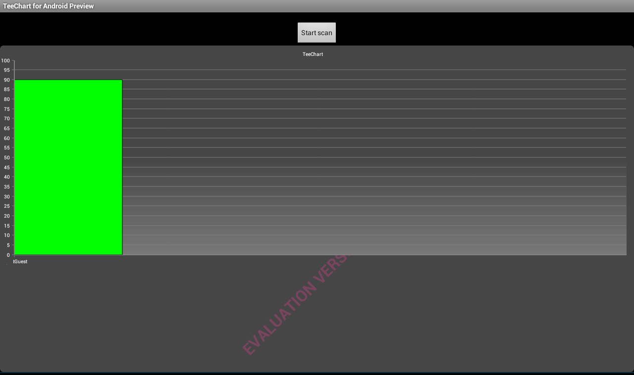

In addition to my previous post, also please consider this one for my second issue.
I have made a minor change to the previous attached file to re-create my problem with the single bar.
In onCreate I just added to the chart just one bar.
WIFIStatistics.rar
(2.88 KiB) Downloaded 1808 times
As you will see when the wifi statistics activity is launched, the main chart displays a single bar but there is no sub chart.
Please let me know if you need further information in order to provide me with feedback on the reported issues.
Thank you.

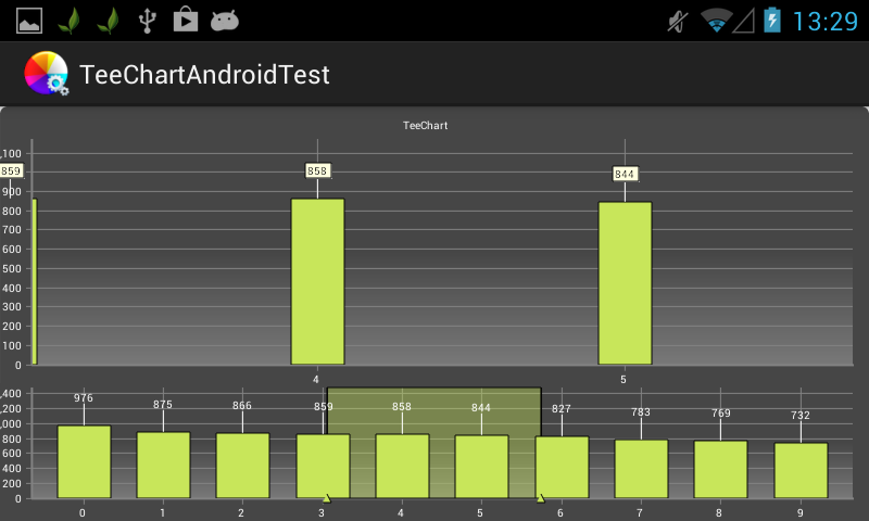

3. I'm trying to change the position of the subchart panel under a certain condition. Since the bars are updated dynamically, I need to handle the following case:
a. The subchart displays i.e. 10 bars and the panel location is between the 8th to 10th bar.
b. The subchart is updated and now it shows 5 bars. Since I maintain the last panel location, the panel will not show as its last location is beyond the 5th bar.
c. I need to check if the last panel location is beyond the maximum x subchart axis and if it is, then set the panel location at the beginning of the subchart.
I tried the following code at the chartPainted event, however, the getMaximum always returns 0 so it erroneously re-initializes the panel. Where do I need to perform this check and re-initialize the panel's location? Or do I need to use something else in the chartPainted event?

Eliana wrote:3. I'm trying to change the position of the subchart panel under a certain condition. Since the bars are updated dynamically, I need to handle the following case:
What about adding some condition after populating the series, and set the ColorBand to the desired position if needed? Ie:
			            if (((s.getColorBandTool().getStart() < availableNetworks.getXValues().getMinimum()) ||
			                 (s.getColorBandTool().getStart() > availableNetworks.getXValues().getMaximum())) &&
			                ((s.getColorBandTool().getEnd() < availableNetworks.getXValues().getMinimum()) ||
			                 (s.getColorBandTool().getEnd() > availableNetworks.getXValues().getMaximum()))) {
			            	s.getColorBandTool().setStart(scrollPagerChart.getAxes().getBottom().getMinimum() + (scrollPagerChart.getAxes().getBottom().getRange() / 3));
			            	s.getColorBandTool().setEnd(scrollPagerChart.getAxes().getBottom().getMinimum() + (scrollPagerChart.getAxes().getBottom().getRange() * 2 / 3));

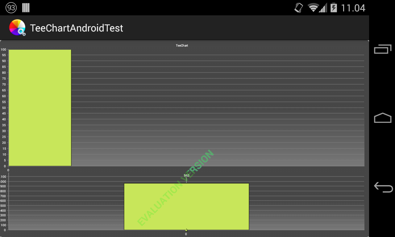

After having a look at the example project, I have updated the library to the latest version and the issue with the single bar has been solved.
Also, thanks for the code provided regarding the colorband position, it covers the main requirements so no further investigations are needed.
I do have an issue which I don't recall if it happened prior to updating the library. I have modified the sample project you provided to show more bars and reproduce the issue. As you can see in the following screenshot, the mark above the bar at the edge of the main chart appears outside the main chart area and on top of the y axis.
Is there a way to avoid this from happening?

Post by Marc » Fri Jul 18, 2014 2:49 pm
Hello Eliana,
Yes, there seems to have been a problem there. We've made a modification to the TeeChart code to correctly clip Bar Marks outside of the Axis bounds. The change will be included with the next update.
