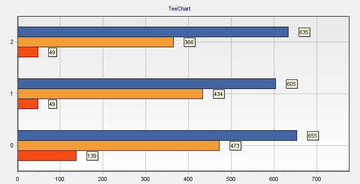

Hello TeeChart,
I'll show you the following Screenshots:
1.
Screen Problem Color-Lines.png (16.79 KiB) Viewed 16317 times
Here you see, that when I scroll in the chart, the color-lines are getting over the drawing-area-bounds (see marked inside the red box). Is it an bug, or am I able to disable this?
2.
Screen Problem Chart over Bounds.png (19.97 KiB) Viewed 16312 times
Here you see, that I need to have a chart, that is bigger than it is possible to show bars (because the place is very limited, where I draw the chart). The next bars (not able to be shown) should be able to be reached by scrolling. But you see, that the Chart-Axes are to big. As next you see in the red box, that the raster of the chart (name "2012") exceed the border of the drawing-area.
Is it possbile to get it cleanly?
I hope you understand what I mean.
Thank you very much,
Perbit

Perbit wrote:1.
This sounds the same discussed here:
http://www.teechart.net/support/viewtop ... 10&t=10658
Perbit wrote:2.
I'm trying to reproduce this with the following code and TeeChart Java Swing and the following code, but it seems to work fine for me here:
        for(int i=0; i<3; i++) {
            HorizBar bar1 = new HorizBar(tChart1.getChart());
            bar1.fillSampleValues();
            bar1.setCustomBarWidth(20);
        tChart1.getAxes().getLeft().setMinMax(-0.5, 2.5);
Could you please modify the code above (or arrange a simple example project) so we can reproduce the problem here?
