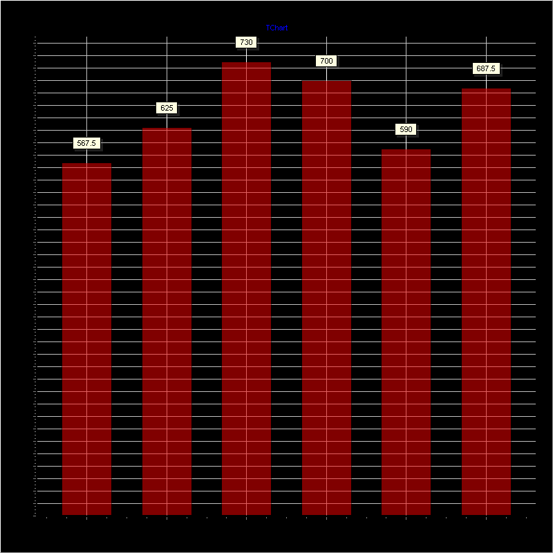

I am using the TeeSaveToPNG function to save a bar chart with 50% transparency, but when I looked at the saved PNG the transparency has all gone, and the bars are 100% solid. Surely I should get a WYSIWYG image of whats on the screen, or am I missing something?

In my problem I am saving multiple images and the uploading them to my website and using a call like with a specific size:
TeeSaveToPNG(Chart1,Path,1200,600)
And this fails, but if I don't specify the size and use the default size like in your example transparency works.
TeeSaveToPNG(Chart1,Path)
It also fails if you use
TeeSaveToJPEG
and specify a size.

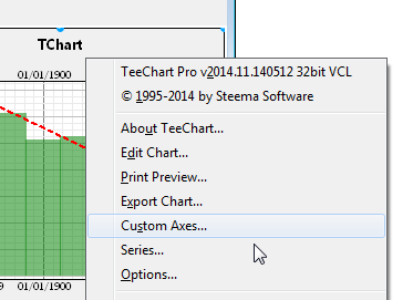

How do I check for the exact build number?
To check the exact build number, the easiest way is next:
1.- Open your IDE, add Chart in the form and then do click on chart with right button and choose About TeeChart.

The result did have transparent bars yes, but...
