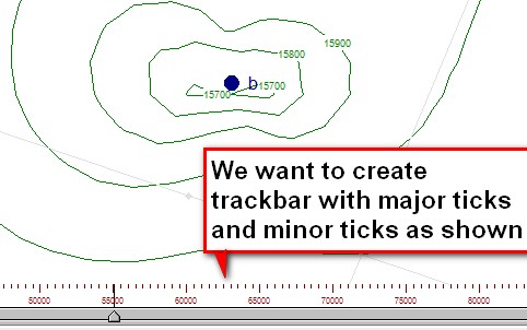

We want to create contour and its interaction with the track bar with the chart(contour) when we scroll it.
Fig 1 image

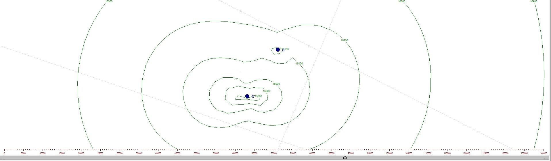

As shown in fig-1, when we scroll the track bar then contour properties changes as shown in fig-2 below
Fig.2 image
