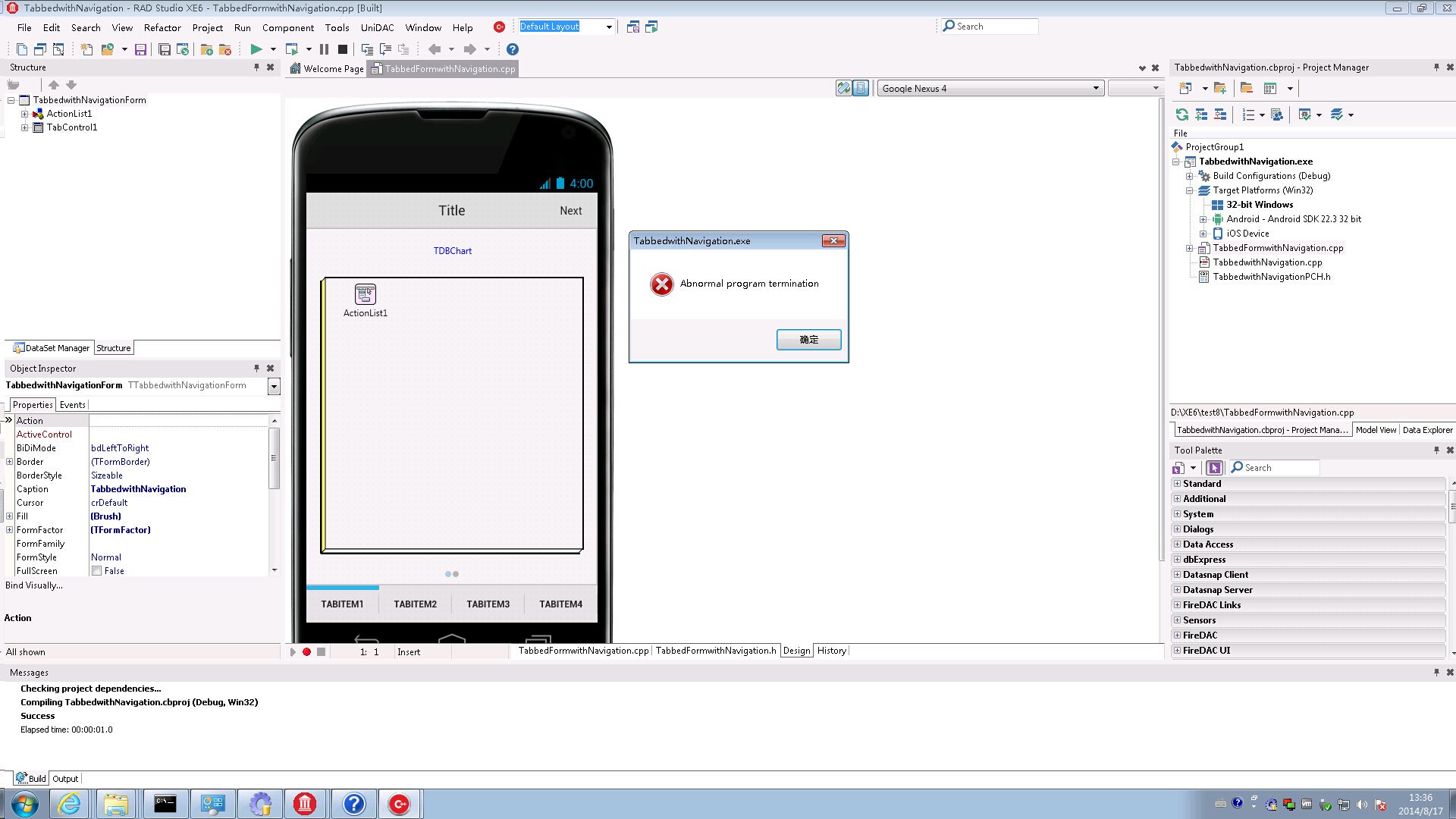

I new a project, compiled on win32 error after new construction, drag a TDBChart to the interface compiler error occurs. :(
Please tell me why?

attachment file is question photo.

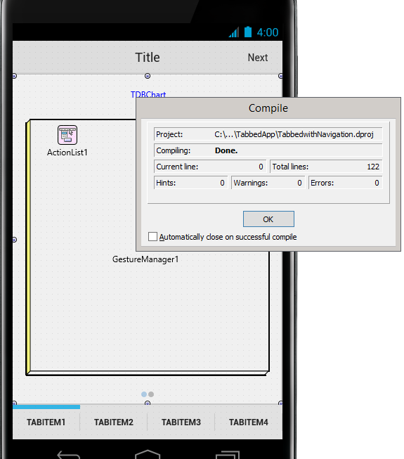

Post by Yeray » Thu Aug 21, 2014 8:16 am
I've tried to reproduce the problem but I can't. These are the steps I followed:
- Open RAD XE6
- Create a new application through "File -> New -> FireMonkey Mobile Application - Delphi"
- Select "Tabbed with Navigation"
- Select the folder where you want the application to be created.
- Ctrl+F9 to build. It builds fine.
- Drop a TDBChart into the form.
Am I missing anything?
