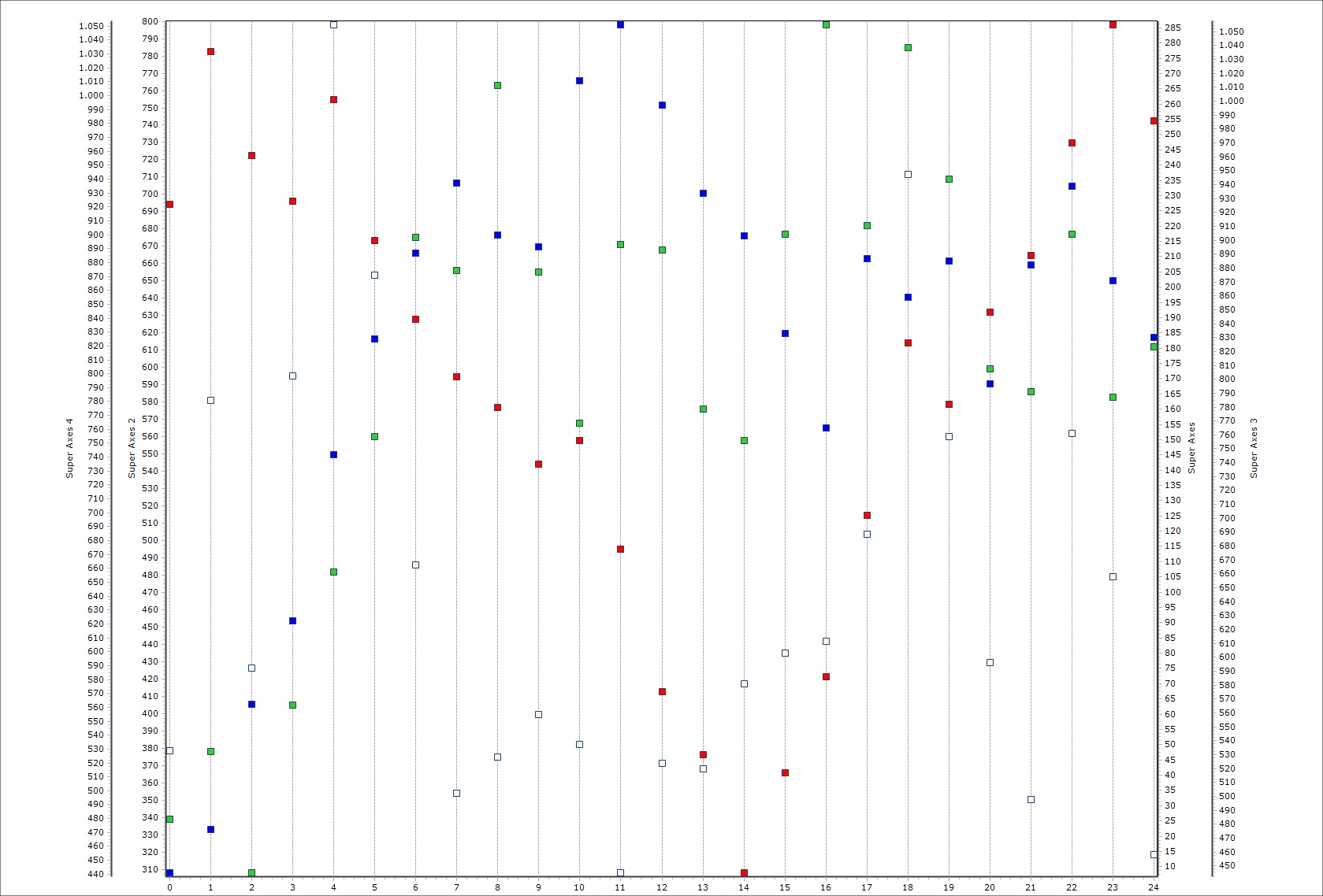

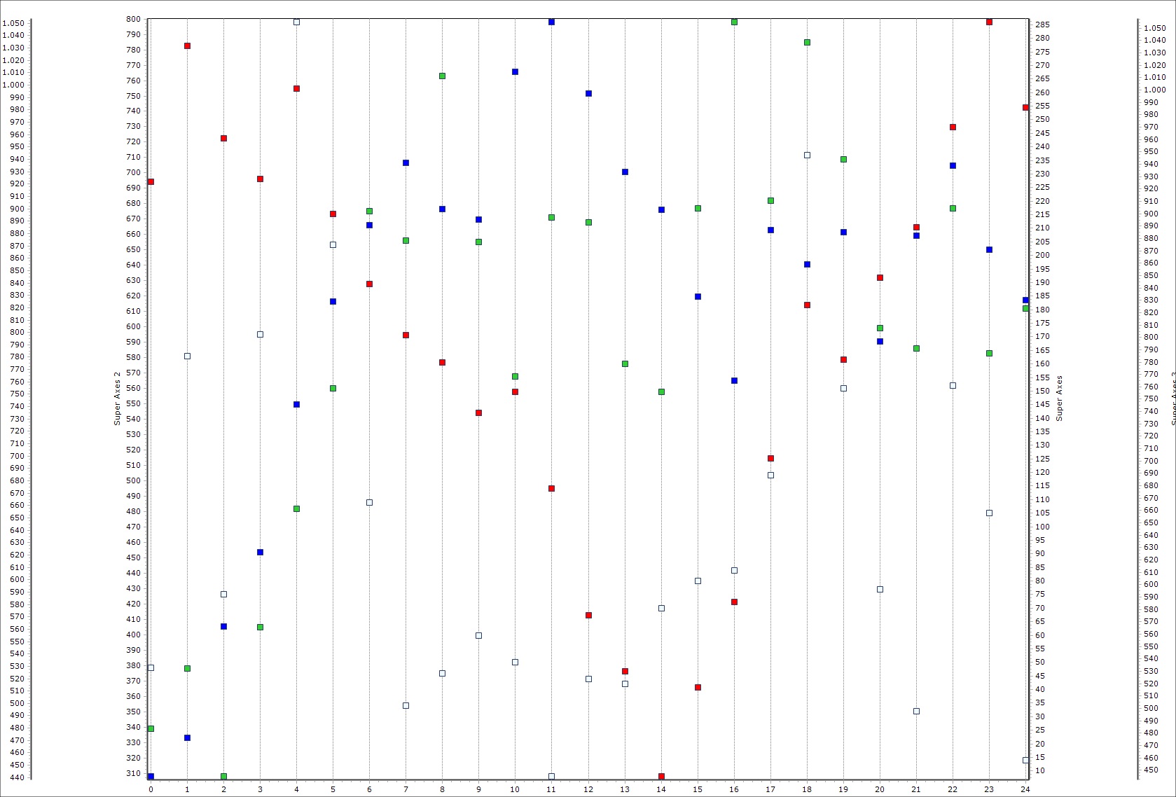

I have added two images illustrating the problems with the axes.
Kind regards - HH Friis

        private void PlaceAxes(int nSeries, int NextXLeft, int NextXRight, int MargLeft, int MargRight)
            const int extraPos = 50;
            const int extraMargin = 105;
            //Variable
            int MaxLabelsWidth;
            int lenghtTicks;
            int extraSpaceBetweenTitleAndLabels;
            if (tChart1[nSeries].Active)
                MaxLabelsWidth = tChart1.Axes.Custom[nSeries].MaxLabelsWidth();
                lenghtTicks = tChart1.Axes.Custom[nSeries].Ticks.Length;
                extraSpaceBetweenTitleAndLabels = 0; //(tChart1.Axes.Custom[nSeries].Title.Width);//<- here
                //extraSpaceBetweenTitleAndLabels = (tChart1.Axes.Custom[nSeries].Title.Width);//- tChart1.Axes.Custom[nSeries].MaxLabelsWidth());
                if (tChart1.Axes.Custom[nSeries].OtherSide)
                    tChart1.Axes.Custom[nSeries].RelativePosition = NextXRight;
                    NextXRight = NextXRight - (MaxLabelsWidth + lenghtTicks + extraSpaceBetweenTitleAndLabels + extraPos);
                    MargRight = MargRight + extraMargin;
                    tChart1.Axes.Custom[nSeries].RelativePosition = NextXLeft;
                    NextXLeft = NextXLeft - (MaxLabelsWidth + lenghtTicks + extraSpaceBetweenTitleAndLabels + extraPos);
                    MargLeft = MargLeft + extraMargin;
                tChart1.Panel.MarginLeft = MargLeft;
                tChart1.Panel.MarginRight = MargRight;
                nSeries++;
                if (nSeries <= tChart1.Series.Count - 1)
                    PlaceAxes(nSeries, NextXLeft, NextXRight, MargLeft, MargRight);
        private void checkBox1_CheckedChanged(object sender, EventArgs e)
            tChart1[0].Active = checkBox1.Checked;
            tChart1.Axes.Custom[0].Visible = tChart1[0].Active;
            tChart1.Draw(); //<- here
            PlaceAxes(0, 0, 0, 0, 0);
        private void checkBox2_CheckedChanged(object sender, EventArgs e)
            tChart1[1].Active = checkBox2.Checked;
            tChart1.Axes.Custom[1].Visible = tChart1[1].Active;
        private void checkBox3_CheckedChanged(object sender, EventArgs e)
            tChart1[2].Active = checkBox3.Checked;
            tChart1.Axes.Custom[2].Visible = tChart1[2].Active;
        private void checkBox4_CheckedChanged(object sender, EventArgs e)
            tChart1[3].Active = checkBox4.Checked;
            tChart1.Axes.Custom[3].Visible = tChart1[3].Active;

To resolve the issue you speak of, all that is necessary is the following change:
      PlaceAxes(2, 0, 0, 0, 0); //<- here
As I say, I think your code needs a little more work before being robust.

I have tried to change it in accordance with your instructions, see code below
1) Start with all series active=true
2) then try to inactive series 3 and re-activate the series (uncheck checkbox3, then recheck checkbox 3)
That makes the axes overlap...??

Friis wrote:Hi
Try:
    private void PlaceAxes(int NextXLeft, int NextXRight, int MargLeft, int MargRight)
      //Variable
      int MaxLabelsWidth;
      int lenghtTicks;
      for (int nSeries = 0; nSeries < tChart1.Series.Count; nSeries++)
Friis
