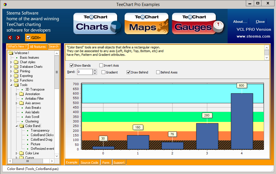

Have you tried using a ColorBand Tool?
The features demo shows an example about it:

That would be exactly what I need.
Is it available in FMX - I'll check.

This worked great for me. Thanks.
