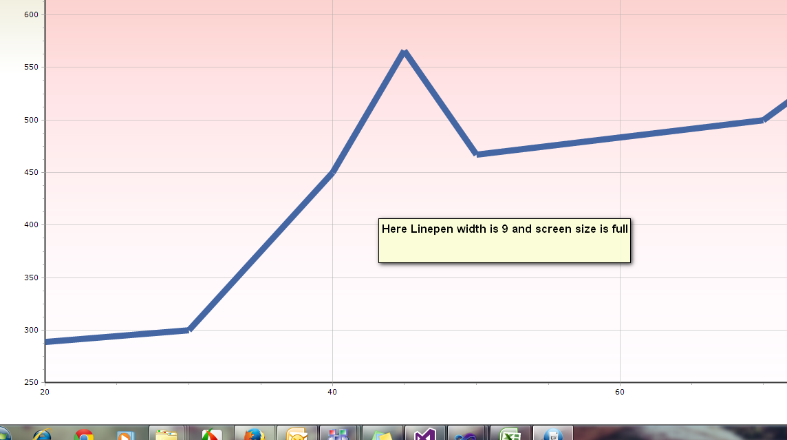

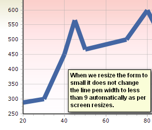

Is there is any way manage Series size, tools size ,Axis labels size,header text size when we resize the chart.
As shown in image1 with full screen.
and image2 when screen size is small.
There is any property in teechart to resize whole chart when chart size changes.
