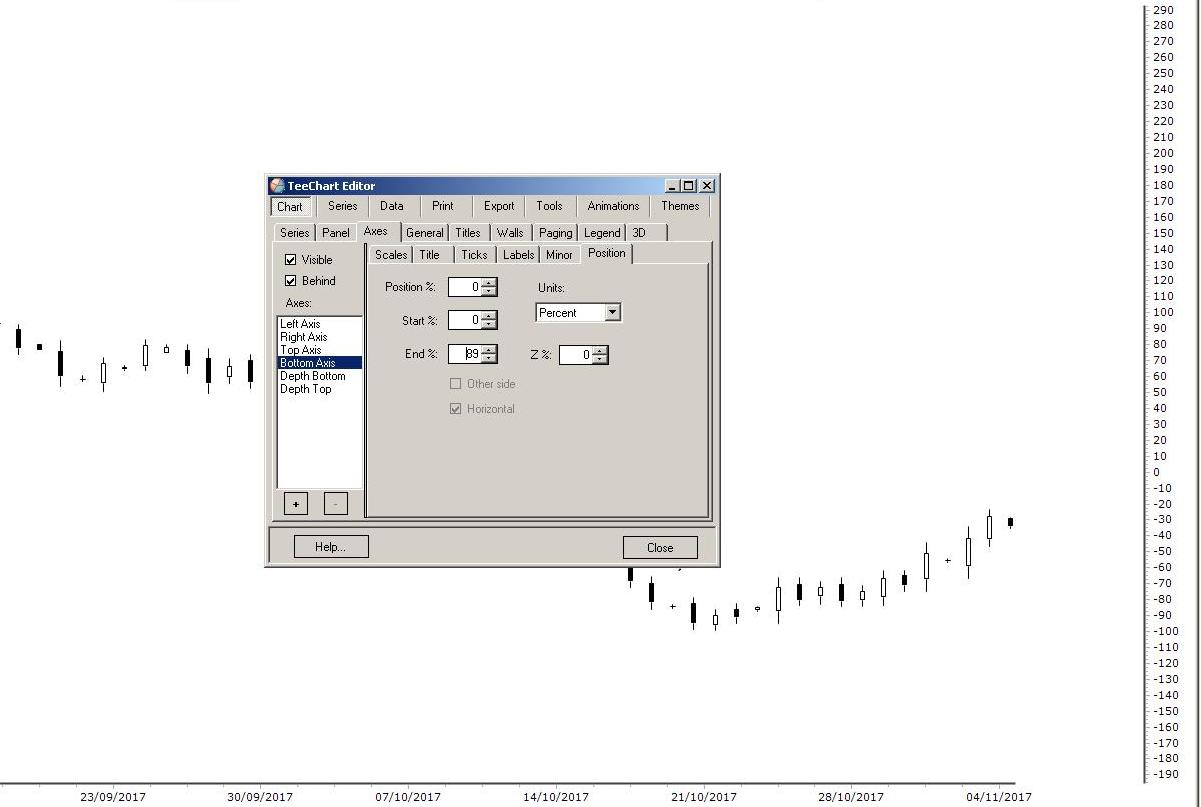

We have a requirement wherein we need to keep margin between Series and Right Axis. We have achieved the same using TeeChart Editor, but as shown in attached screenshot, line of bottom axis is also shifted to its left, thereby creating a invisible line. Please provide us solution on this.

Hi Quant,
What about using MaximumOffset property instead?
      tChart1.Axes.Bottom.MaximumOffset = 100;

Post by Quant » Mon Feb 09, 2015 9:26 am
It worked. Thank you very much.
