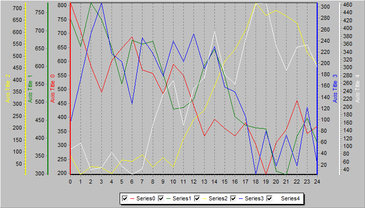

This is what I get with TeeChart ActiveX v7.0.1.4:

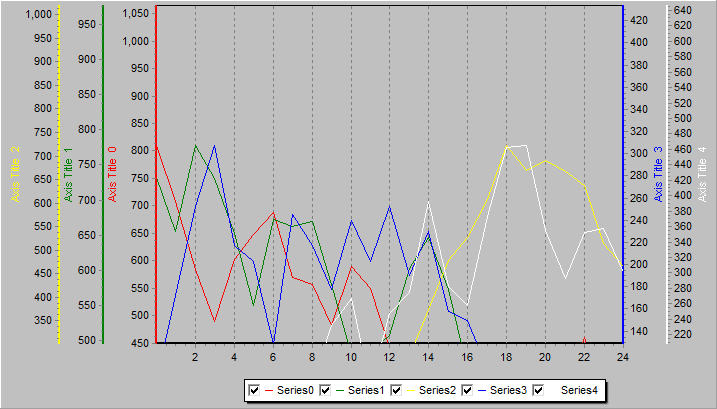

If I scroll the chart a bit to see a longer label for the yellow axis, I see the margin on the left gets bigger to fit the new:
Debugging I could also see the difference. MaxLabelsWidth for nSeries=2 is 21 without scrolling and 30 when the "1.000" label is shown.
