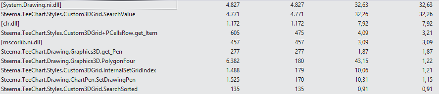

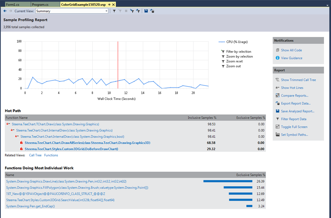

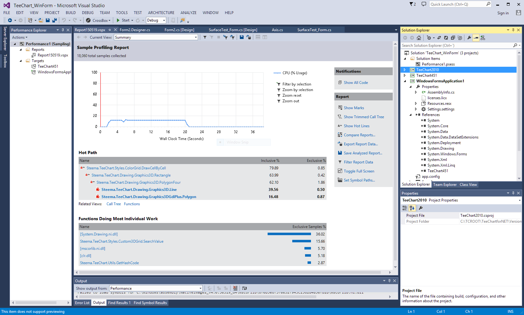

This is what your application looks like using the present source code and VS2013's profiler:
As you can see, the assembly taking up the time here is System.Drawing.dll. I ran a test using the Stopwatch class and found that the application on this relatively old machine runs in 12040 milliseconds, whereas using a version of TeeChart.dll from 2009 the application run in 14420 millseconds. While I agree that over 12 seconds for the chart to render is unacceptable, I'm not entirely sure that older versions of TeeChart would have run significantly quicker. What is more, given that it is the drawing of Lines and Polygons which is taking the time, I'm not sure how to better this performance by doing something other than feeding the chart less lines and polygons to draw. I'll have to have a further think about this.

I do not get the flat line like you. Also, try resizing the window. I get that the resize takes almost twice as long.
In addition (although it has been a while since I looked at this) I had found that in the past using
this._chart.Aspect.SmoothingMode = System.Drawing.Drawing2D.SmoothingMode.HighSpeed;
ran faster. However, it seems that now it is having minimal improvement.

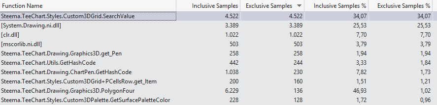

I'm using the latest TeeChart.dll, version 4.1.2015.05140.
Using a more modern machine, I get the following results:
TeeChart.dll 4.1.2015.05140 (14/05/2015): draw, 6658ms. resize, 6358ms
TeeChart.dll 3.5.3700.30574 (17/02/2009): draw, 8188ms. resize, 6770ms
In both versions of TeeChart the most called TeeChart function is the same:
TeeChart.dll 4.1.2015.05140:
TeeChart.dll 3.5.3700.30574:
what is more, the Steema.TeeChart.Styles.Custom3DGrid.SearchValue function is identical in both versions. I have added a further improvement to ColorGrid performance to our database with id=1215 so that further attention can be given to this area.
