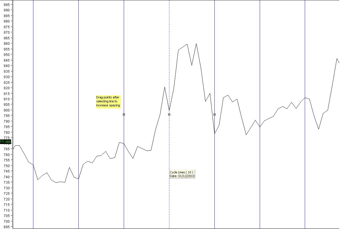

First of all thank you for adding new styles (e.g.Ellipses,Rectangles) in Drawline tool. I am surprised that Triangle is still not included in this tool. It will help us alot if you add Triangle. I will be glad if you add more features to parallel lines like number of line property. For example if i set no. of line to 3 then while drawing it will draw 3 equidistance parallel lines. This is called as Cycle Lines in Financial Charts. I am adding sample image for your referance.
