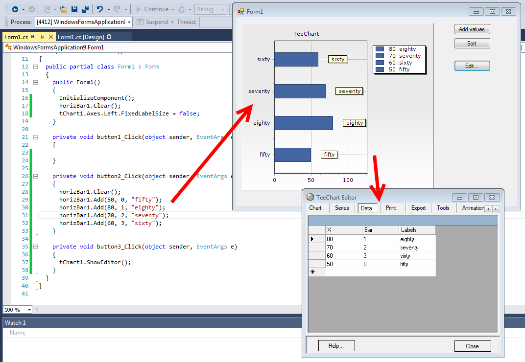

I have a simple application with a horizontal bar with labels. You can see in my screenshot 1 how I created the bar series and how the result looks like.
Screenshot 1

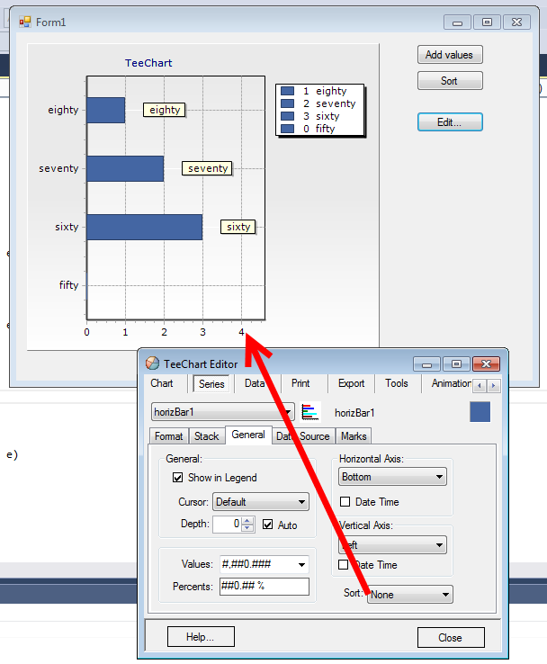

When I modify the sorting of this horizontal bar (by default it's set to 'descending') towards sorting 'None', the sorting appears as ascending and the X-axis displays now the Y-value... very strange (see screenshot 2).
Screenshot 2
Can someone figure out or explain what's going on?
Re: Series labels and sorting
Post by Christopher » Tue Jun 09, 2015 8:18 am
DaVinci wrote: Can someone figure out or explain what's going on?
Yes, this appears to be a small defect in the Chart Editor which is now resolved. You will note that at runtime the code works correctly, e.g.
    HorizBar bar;
      bar = new HorizBar(tChart1.Chart);
      bar.Add(50, 0, "fifty");
      bar.Add(80, 1, "eighty");
      bar.Add(70, 2, "seventy");
      bar.Add(60, 3, "sixty");
    private void button4_Click(object sender, EventArgs e)
      bar.XValues.Order = ValueListOrder.Ascending;
      bar.CheckOrder();
