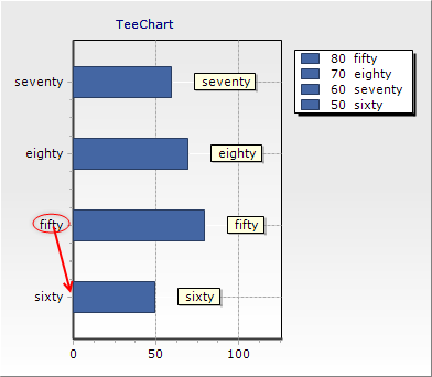

but the labels do not correspond with the bar values: bar with value '50' should correspond with label "fifty".
The result of the above code is:
What is the relation of the labels and the bars?

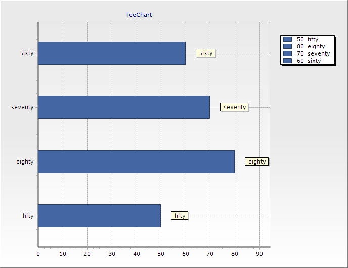

Gives me the following:
Does this code give you different results? Which version of TeeChart.dll are you using?
