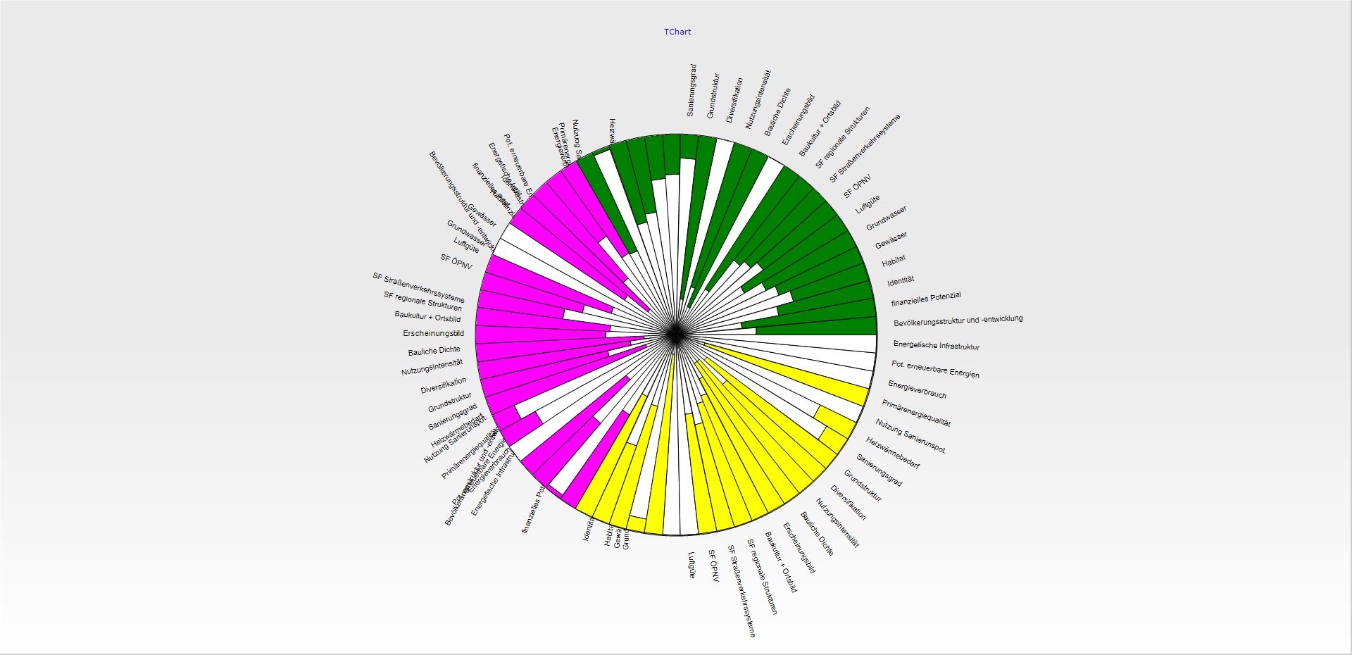

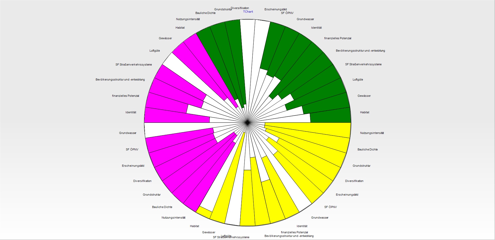

I have an TRoseSeries-chart and want to label the segments with labels. How can I position the labels with a larger margin and give them arrows so that every label points to its segment?
Is it possible to have a larger margin from the labels to the chart at the middle of the right and left side of the chart?
If I use Marks instead of the labels, the marks are positioned on my chart, the segments are partially hidden.
TRoseSeries with labels
marks instead of the labels
Kind regards
Peter

Hi Peter,
peterlepan wrote: How can I position the labels with a larger margin and give them arrows so that every label points to its segment?
It's a little bit tricky but possible with custom marks position as shown in the code snippet below. Also find attached the complete example project.

peterlepan wrote: Is it possible to have a larger margin from the labels to the chart at the middle of the right and left side of the chart?
Yes, you can modify that depending on angle values, for example:

Hi Narcís,
thank you for your answer, but the solutions are really "tricky".
If I use labels and position them with a large margin, the right half of the chart is very nice, but look at the left side! Why are the labels on the left side so confused? Can't they look like the labels on the right side?
Have you an idea for this problem? I wish my labels look like the beams from the sun ;-) and the chart is the sun
Sincerely yours
Peter

Re: Labels on TRoseSeries
Post by peterlepan » Fri Jun 12, 2015 3:33 pm
Hi Narcís,
my problem was, that some of the labels where too long. Now, we have shorted the labels to three signs and it looks fine. The only caveat now is a little offset on top and bottom of the chart labels. Thats why the label text is left-aligned. Is it possible, to create an ideal cirlce from the labels?
