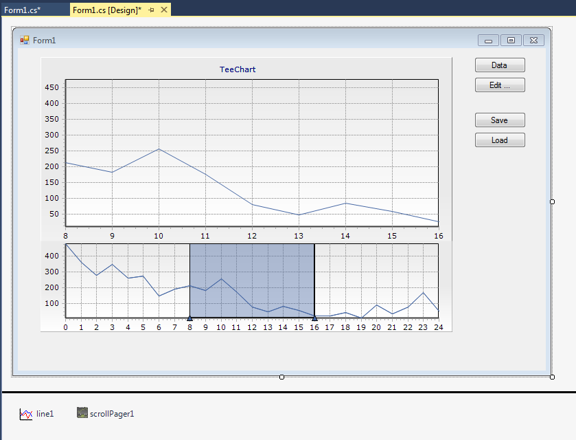

I have a simple application which has one line series and a ScrollPager tool.
I can fill my line series with data and afterwards, save my chart to a file (without data).
I restart my application and press the load button to prepare my chart with the file I saved before.
When I add data to the chart (using the Data button), no data points are drawn. If I look with the Editor, I can see that the ScrollPager tool still uses my line series.
What's wrong or missing?
I added my application as attachment.
DaVinci.

Post by Christopher » Fri Jul 03, 2015 9:24 am
DaVinci,
DaVinci wrote:I added my application as attachment.
Thank you.
The reason the data is not being drawn is because you have set "IncludeData" to false. If you set it to true, which is default, all should work as expected, e.g.
    private void loadButton_Click(object sender, EventArgs e)
      tChart1.Import.Template.Load(filename);
    private void saveButton_Click(object sender, EventArgs e)
      tChart1.Export.Template.IncludeData = true;
      tChart1.Export.Template.Save(filename);
