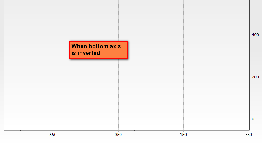

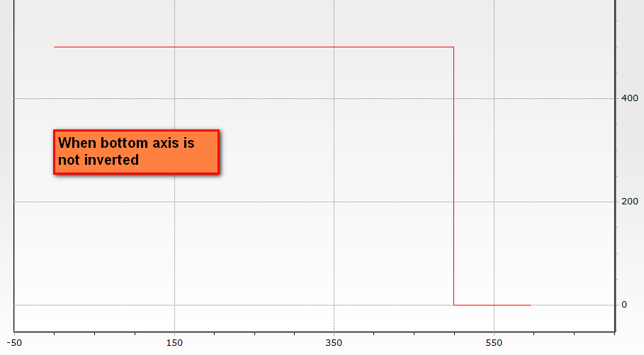

We are creating line using series and setting property "line.Stairs=True;" and "line.VertAxis = VerticalAxis.Right;".
But we press button "Invert" to invert bottom axis but it does not shows reflection on line properly as shown in Fig. 2
Fig 1: shows line without axis inverted.
Fig 1
Fig 1.png (9.66 KiB) Viewed 7772 times
Fig 2: shows line with axis inverted.
Fig 2
Fig 2.png (9.98 KiB) Viewed 7767 times

I'm not sure that this is a defect. Have a look at this code:
      Line series = new Line(tChart1.Chart);
      series.FillSampleValues(3);
      series.Stairs = true;
      Annotation tool = new Annotation(tChart1.Chart);
      for (int i = 0; i < series.Count; i++)
        tool.Text += " " + series.YValues[i].ToString();
    private void button4_Click(object sender, EventArgs e)
      tChart1.Axes.Bottom.Inverted = !tChart1.Axes.Bottom.Inverted;
the annotation tool prints out the three series values. As you can see, when the axis is inverted the shape of the line series changes, but this is not incorrect - the first YValue in the series is always correctly plotted.

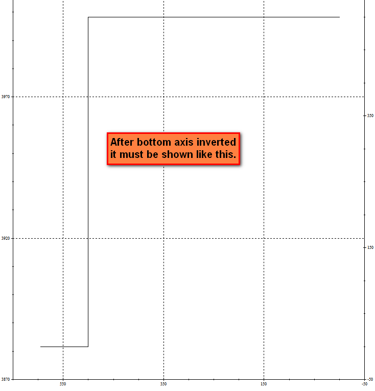

Hi Steema Support,
Yes, you right when we see the value then it shows the correct value but line shown in the chart is not correctly inverted.
When line inverted correctlythen it looks like fig 1
Fig1
fig 3.png (10.33 KiB) Viewed 7756 times

amol wrote: When line inverted correctlythen it looks like fig 1
That's right, and that's what it looks like using your data in a default chart, e.g.
      //series.FillSampleValues(3);
      series.Add(10, 39);
      series.Add(50, 50);
      series.Add(59, 68);
one or other of your chart modifications must be overriding the default behaviour of the chart.
