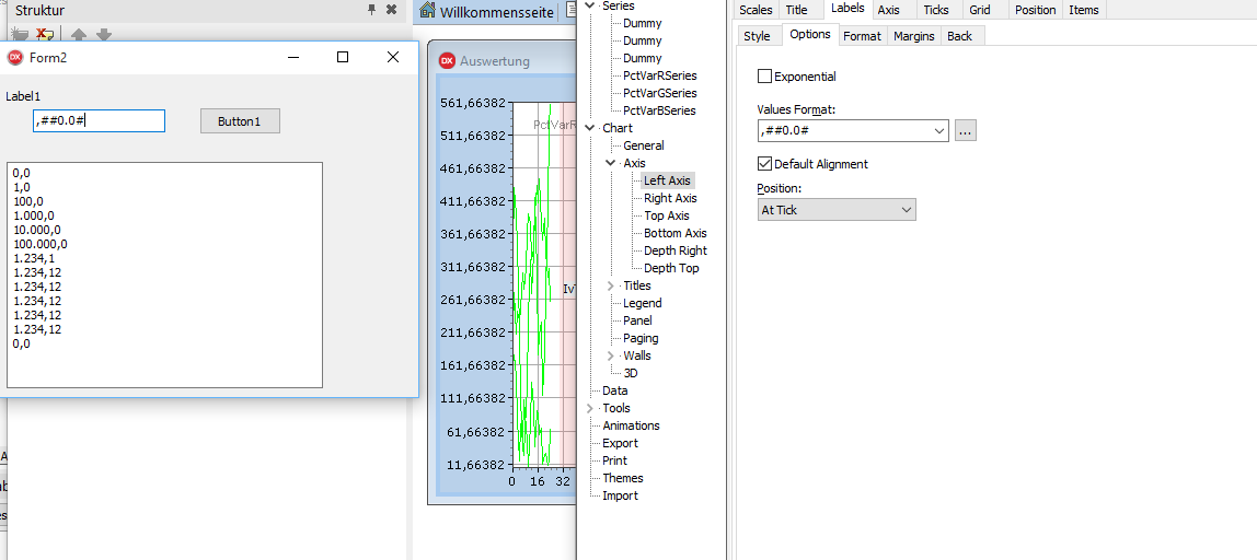

Hi
I got another strange thing with the AxisValueFormat (and possibly others) not working as expected:
The screen-shot show Delphi with a form ("Auswertung") and the LeftAxis - valus and its "Values Formt:"
On the left there is a little tool (Form2) compiled an running to show some numbers with a certain format mask using Delphis FormatFloat - funktion.
As you can see, there are two totally different results. While the Delphi function seems to work as expected AxisValueFormat does some weird possibly mixing format specifiers and local format settings?

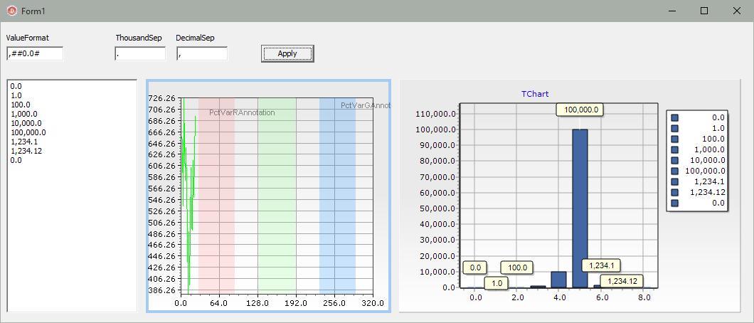

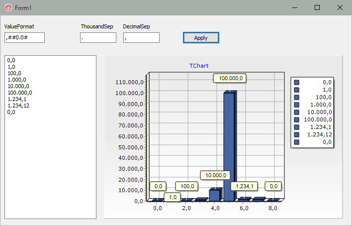

I've prepared a simple example project to reproduce this and it seems to work fine form me here.
Here is how it looks:
Could you please modify the project so we can reproduce the problem here?

Re: AxisValueFormat not working as expected
Post by Yeray » Wed Sep 30, 2015 11:37 am
I see the new chart in the project but you aren't modifying the axes AxisValuesFormat when the button is clicked.
Adding this it works fine for me here:
  MyFilterChart.Axes.Left.AxisValuesFormat:=Edit1.Text;
  MyFilterChart.Axes.Bottom.AxisValuesFormat:=Edit1.Text;
  MyFilterChart.Repaint;
