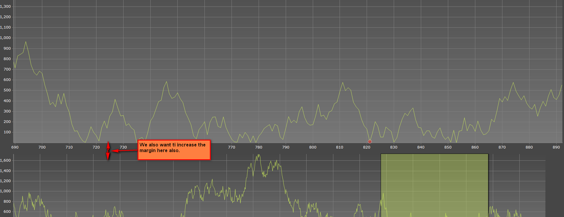

We also want to set margin between these two curves.As shown in image below.
Set margin
set margin.png (79.13 KiB) Viewed 8118 times
Re: To set margin of scroll Pager chart
Post by Christopher » Wed Sep 30, 2015 8:13 am
Hello!
You can try e.g.
      tChart1.Header.Text = "Scroll Pager Tool Demo";
      tChart1.Series.Add(series = new Line());
      series.FillSampleValues(1000);
      tChart1.Tools.Add(tool = new ScrollPager());
      tChart1.Tools.Add(point = new NearestPoint());
      tChart1.Tools.Add(annotate = new Annotation());
      tChart1.GetAxesChartRect += TChart1_GetAxesChartRect;
      blackTheme = new BlackIsBackTheme(tChart1.Chart);
      blackTheme.Apply();
      point.Brush.Color = tool.PointerHighlightColor;
      point.DrawLine = false;
      point.Size = 6;
      point.Direction = NearestPointDirection.Horizontal;
      point.Series = series;
      point.Change += new EventHandler(point_Change);
      this.SizeChanged += new System.EventHandler(this.Tools_ScrollPager_SizeChanged);
      annotate.Position = AnnotationPositions.LeftTop;
      annotate.Text = "Y-Axis Value:";
      annotate.Shape.Shadow.Visible = false;
      annotate.Shape.Font.Color = tChart1.Header.Font.Color;
      annotate.Shape.Color = tool.PointerHighlightColor;
      annotate.Shape.Pen.Visible = false;
      annotate.TextAlign = StringAlignment.Center;
    private void TChart1_GetAxesChartRect(object sender, Steema.TeeChart.GetAxesChartRectEventArgs e)
      Rectangle rect = e.AxesChartRect;
      e.AxesChartRect = Utils.FromLTRB(rect.Left + 100, rect.Top, rect.Right - 100, rect.Bottom - 200);
