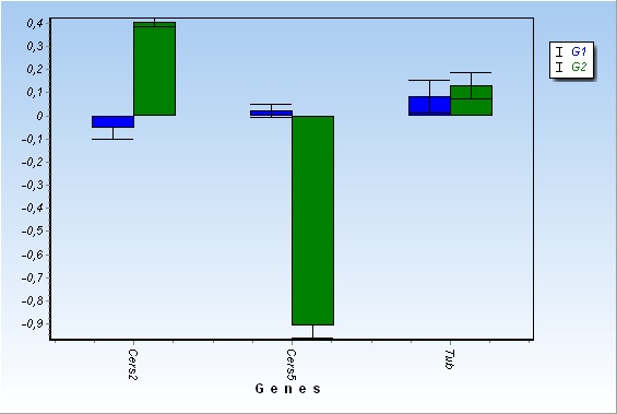

Hi
It seems that ErrorBars are not plotted correctly when the Bar has a value below Zero. Only one side of the ErrorBar appear in the plot. This error has been in all previous versions. Last year I found a few posts in the forum claiming that it is corrected, but does not seems so. The following plot is from Tee Chart v2105.14.150.120:

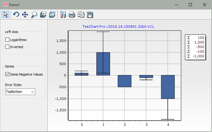

I get an error when trying to load this tee file, but I've made a simple example project trying to reproduce several situations:
testErrorBars.zip
(2.23 KiB) Downloaded 806 times
emwamin wrote:It seems that ErrorBars are not plotted correctly when the Bar has a value below Zero. Only one side of the ErrorBar appear in the plot.
I could reproduce the problem with the application above:
I'm studying if a small change in the sources is appropriate. This is how it looks with it:

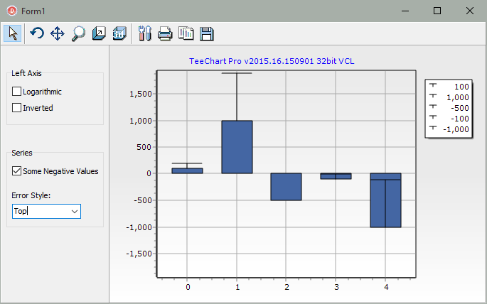

Also note this modification also changes the result of the "Top" ErrorStyle, from this:
To this:
Your feedback will be appreciated.

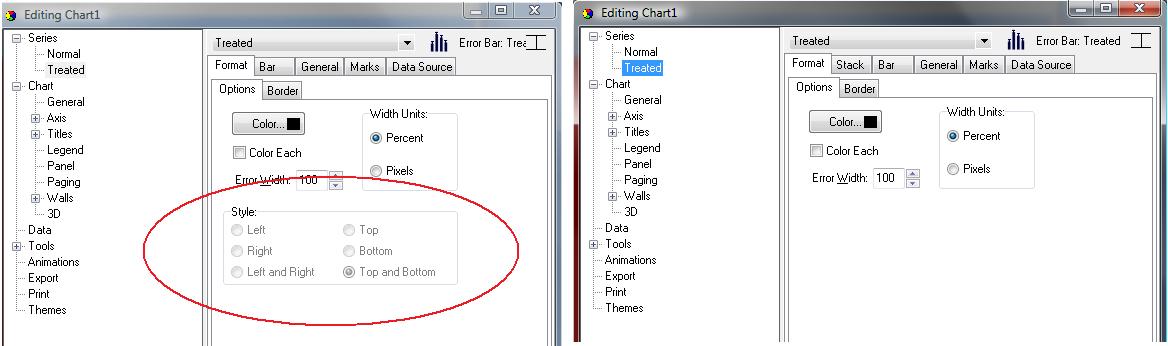

Hi
After making that change I am facing a new problem. In toolbox I get the option for styling the ErrorBar but the controls are disabled. If you switch to another serie and switch back the styling controls are disappeared.
I am using Delphi 7 and TeeChart version 2015.16.150901.
BR
emwamin
Posts: 9674
Re: ErrorBar not plotted correctly
Post by Yeray » Thu Jan 28, 2016 10:32 am
emwamin wrote:In toolbox I get the option for styling the ErrorBar but the controls are disabled. If you switch to another serie and switch back the styling controls are disappeared.
I could reproduce that so I've added it tot he public tracker:
http://bugs.teechart.net/show_bug.cgi?id=1419
Note I've also fixed it for the next maintenance release.
