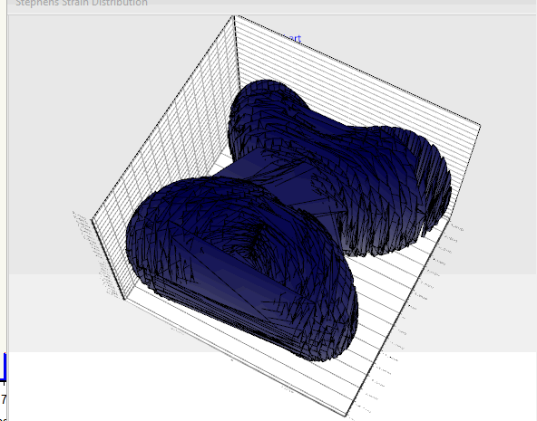

I tried to use TTriSurfaceSeries but then I get this:
Any Hint what I need to do or how I can upload the text file with the XYZ data ?

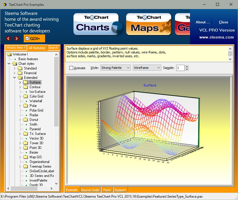

Have you tried setting the WireFrame property to True as in the Surface example?

a TSurfaceSeries doesn't show up at all when adding all the XYZ data and TTriSurfaceSeries doesn't have a WireFrame property.

The TriSurfaceSeries uses triangles (3 point planes) so it's more versatile than the TSurfaceSeries but it doesn't give a good result with your data either.

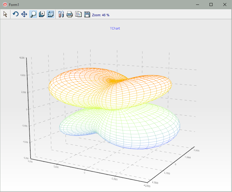

And here it is!
Here the code I used:
uses Series, TeePoin3, TeeGLCanvas, TeCanvas;
var Series1: TPoint3DSeries;
var SeriesTextSource1: TSeriesTextSource;
  Chart1.Canvas:=TGLCanvas.Create;
  Chart1.Legend.Visible:=false;
  Chart1.Aspect.Orthogonal:=false;
  Chart1.Aspect.Zoom:=50;
  Chart1.Chart3DPercent:=100;
  Chart1.Walls.Visible:=false;
  Chart1.Axes.Depth.Visible:=true;
  Chart1.Axes.Bottom.Inverted:=true;
  Chart1.Axes.Depth.Inverted:=true;
  Chart1.Axes.Depth.Increment:=1000;
  Chart1.Axes.Left.Increment:=2000;
  Chart1.Axes.Bottom.Increment:=2000;
  Chart1.Axes.Left.SetMinMax(-6000, 6000);
  Chart1.Axes.Bottom.SetMinMax(-4000, 4000);
  Chart1.Axes.Depth.Grid.Style:=psDash;
  Chart1.Axes.Left.Grid.Style:=psDash;
  Chart1.Axes.Bottom.Grid.Style:=psDash;
  Series1:=Chart1.AddSeries(TPoint3DSeries) as TPoint3DSeries;
  Series1.UseColorRange:=false;
  Series1.UsePalette:=true;
  Series1.OnGetPointerStyle:=Series1GetPointerStyle;
  SeriesTextSource1:=TSeriesTextSource.Create(Self);
  SeriesTextSource1.Automatic:=False;
  SeriesTextSource1.AddField('X',1);
  SeriesTextSource1.AddField('Z',2);
  SeriesTextSource1.AddField('Y',3);
  SeriesTextSource1.FieldSeparator:=#9;
  SeriesTextSource1.FileName:='F:\Downloads\sph-strain\sph-strain.txt';
  SeriesTextSource1.Series:=Series1;
  SeriesTextSource1.Active:=true;
