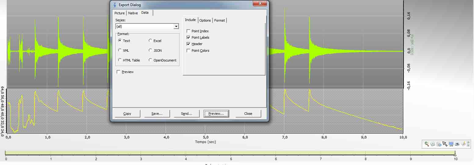

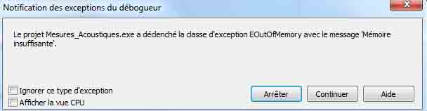

When I try to save the raw data in text format using the TeeExport dialog box (slide 1) I quite often get an error reporting "not enough memory..." (slide 2). This situation mainly occurs for large series ( over 100'000 points).
It's stange: I save all the x-y couples for each series "by myself" with a very easy procedure and I don't notice that it was necessary to allocate memory for this action: with llops over series and number of points I never met any problems. Maybe you store the list in a listbox wich can be huge in some situations(?)
Could you tell me where the problem is comming from and how can I avoid it.
Thank you in advance for your answer.
JPM

Are you pressing "Save..." or "Preview..."? If the later, the problem could be in notepad.
