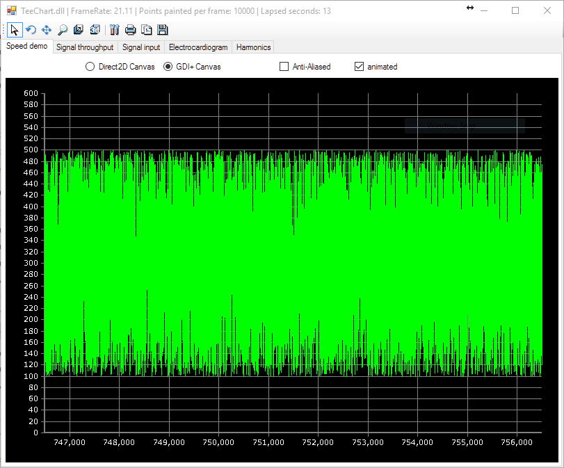

Have you seen the Direct2D demo under:
%programfiles(x86)%\Steema Software\Steema TeeChart for .NET 2015 4.1.2015.08060\Examples\DemoProjectDirect2D\bin\ExecutableDemo\Direct2DDemo.exe
here you can see TeeChart drawing approximately 211,100 points a second in GDI+.
