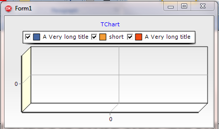

When constructing a Chart with a legend on top plus check boxes and the series titles are alternating long and short
then its impossible to show hide some series by clicking on the check box because the click point is displaced.
In this case clicking the third check box switches the second series ON/OFF.
Is there a fix for that bug ?

Hello Yeray,
I am using the latest TChart version v2015.16. on Delphi 10 (Seattle).
What I did was just putting a TChart on a form and adding 3 Series.
Then you set the series to show on top and you change the series settings to display Check boxes.
Then enter the series title texts you see on my screen shot and you should be able to reproduce this problem.
I think it's the combination of long and short texts.

Hello Yeray,
please see attached project:
TChartLegendBug.zip
(48.5 KiB) Downloaded 671 times
Please try to click the checkbox of the third series.
best regards,
X-ray

Having combined series title lengths I could reproduce the problem so I've added it to the public tracker:
http://bugs.teechart.net/show_bug.cgi?id=1430
