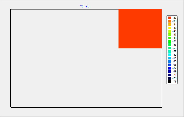

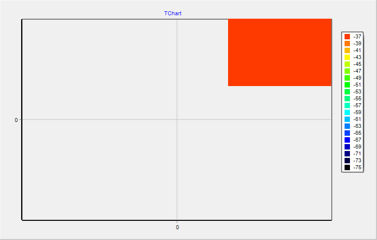

        for i := 0 to 511 do
            for j := 0 to 511 do
                (Chart1.Series[0] as TColorGridSeries).AddXYZ(i+1, random*10{ImgData[i,j]}, j+1);
Note this populates a ColorGrid with x values from 1 to 512, and the same for the z values.
Then, if you want to zoom to display the zone in the horizontal axis between -3 and 3, and the same for the vertical axis, I'd expect a result showing part of the colorgrid and part out of the colorgrid.
I see two options of code to put at your ApplyZoomBtnClick, that give me similar results:
- Option 1. Use SetMinMax function from Bottom and Left axes instead of Top and Right:
  Chart1.Axes.Bottom.SetMinMax(-3, 3);
  Chart1.Axes.Left.SetMinMax(-3, 3);
- Option 2. Use CalcPosValue for values -3 and 3, and from bottom and Left axes to define the Zoom rectangle:
  rect:=TeeRect(Chart1.Axes.Bottom.CalcPosValue(-3), Chart1.Axes.Left.CalcPosValue(-3),
              Chart1.Axes.Bottom.CalcPosValue(3), Chart1.Axes.Left.CalcPosValue(3));
  Chart1.ZoomRect(rect);
