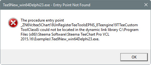

Now I am trying to run Start / All Apps / Steema TeeChart PRO VCL / New Features Demo 64 and get the following error message:

Ran the first uninstall/install (binary) and New Features Demo 64 ran, but no source code available with examples. :(
Ran second uninstall/install (source) and get the same error message again:
New Features 64 error.jpg (44.13 KiB) Viewed 24245 times

I did the same thing here and found no problems.
Are the TeeChart packages modified in your Source code version?
