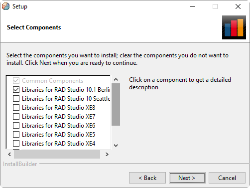

I downloaded and installed. The Delphi UI shows only TeeChard Std, and I don't see where there's a package to install under "Component." What are the handful of points/clicks to get 10.1 Berlin to recognize what was downloaded? Shouldn't the installer have put the appropriate links in the Tool Palette? I was not running Delphi during the Install, so there shouldn't have been any interferences.

There's a moment where the binary installer asks what IDE do your want TeeChart to be installed in. Did you do it?
If you go to the installation path ("C:\Program Files (x86)\Steema Software\Steema TeeChart Pro VCL FMX 2016.17" by default), do you see a "Delphi24" folder (for RAD 10.1 Berlin)?
