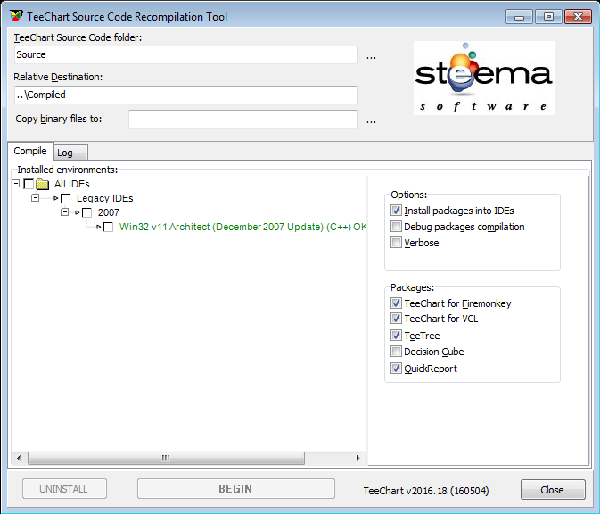

I used the TeeRecompile to install and it appeared to run through OK into:
C:\Program Files (x86)\Steema Software\Steema TeeChart Pro VCL Source Code 2015.16

OK, so I have tried to install Steema TeeChart Pro VCL FMX Source Code 2016.18 but still get the message on loading 'dclTeePro911.bpl not found'. I used the TeeRecompile program to recompile for all IDE's including D2007. Ran as Administrator. It installed into XE5 and D5 OK. Error message is when loading D2007.

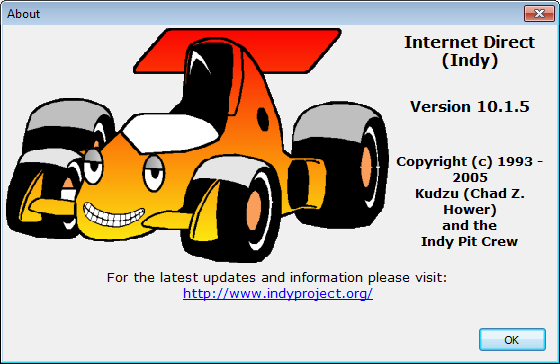

Indy 10 comes with the IDE, and I see it installed in the virtual machine I used to test this:
Have you installed Indy separately?

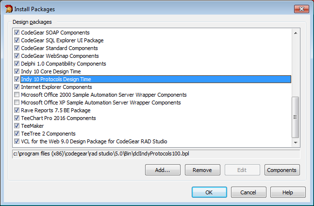

My 'Install Packages' screen looks the same except that the bpl at the bottom is C:\Users\Public\Documents\RAD Studio\5.0\bpl\dclIndyProtocols110.bpl
I also have the Microsoft Office 2000 Sample Automation Server Wrapper Components ticked.
btw, how do you insert a screen shot into a post?

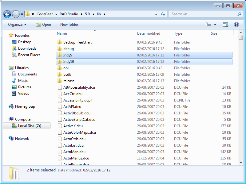

OSNick wrote:If I remember correctly D2007 came with Indy 9 and for some reason we had to upgrade to Indy 10.
The RAD 2007 installation I have in a virtual machine is completely clean and I see both Indy 9 and Indy 10 packages, but Indy 10 packages are the installed into the IDE.

OSNick wrote:My 'Install Packages' screen looks the same except that the bpl at the bottom is C:\Users\Public\Documents\RAD Studio\5.0\bpl\dclIndyProtocols110.bpl
The path "C:\Users\Public\Documents\RAD Studio\5.0\bpl" exists in my virtual machine, but it's empty.

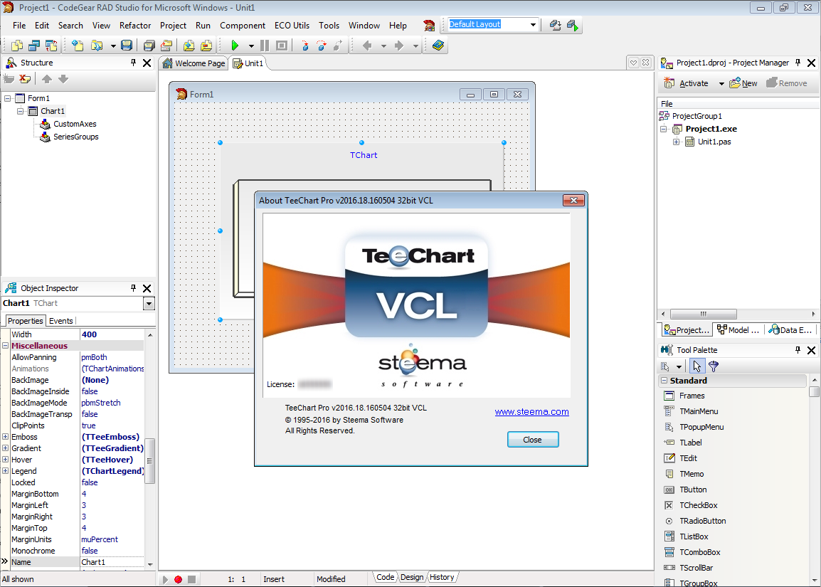

OK, so we removed our copy of Indy components, deleted all traces from the hard drive. Then removed TeeChart. Then from Control Panel, Programs and Features used the RAD Studio installation Modify option which re-downloaded the Indy10 components. After manually adding the browsing path to the dcu's the components loaded OK. Then re-installed TeeChart 2016.18 and it went in fine. I am now going to test the Indy functionality to make sure that everything works. I guess the lesson is not to try to upgrade Indy components if you want to use TeeChart. Still not sure why Teechart v2014 installed without a problem..
Unfortunately the original problems persist but at least we are now on the latest version and I'll start a new thread for that.
