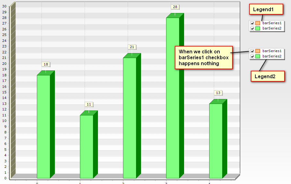

Hi steema support,
We are facing an issue regarding multiple legends,
Why checkbox of legend 2 is not working independently?
We wants to work on checkbox of legend 2.
Multiple Legends.rar
Demo
(58.97 KiB) Downloaded 1217 times
Please provide me any solution asap.

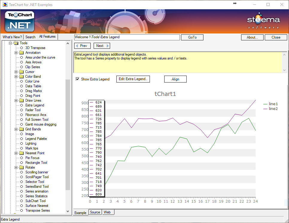

amol wrote:We are facing an issue regarding multiple legends,
I'm not sure what you are trying to achieve with more than one legend, but I think you might like to consider use of the ExtraLegend tool, e.g.

As you suggested we have gone through with the ExtraLegend tool, but here also we are unable to check/uncheck the series that is showing in the tool.
Basically our need is to check/uncheck checkboxes of the legend 2.

amol wrote: Basically our need is to check/uncheck checkboxes of the legend 2.
This requires a little extra code, e.g.
    ExtraLegend legend;
      Line series1 = new Line(tChart1.Chart);
      Line series2 = new Line(tChart1.Chart);
      series1.FillSampleValues();
      series2.FillSampleValues();
      tChart1.Legend.CheckBoxes = true;
      legend = new ExtraLegend(tChart1.Chart);
      legend.Series = series2;
      legend.Legend.LegendStyle = LegendStyles.Series;
      legend.Legend.CheckBoxes = true;
      tChart1.MouseDown += TChart1_MouseDown;
    private void TChart1_MouseDown(object sender, MouseEventArgs e)
      int index = legend.Legend.Clicked(e.X, e.Y);
      if (index != -1)
        Series s = tChart1.Chart.SeriesLegend(index, false);
        s.Active = !s.Active;
