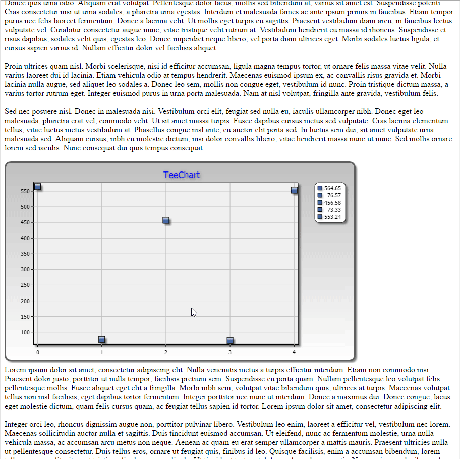

In my graph, I am using tooltip to display the details. The problem is, during the tooltip visible I am scrolling the mouse, at that time tooltip is traversing with the mouse pointer throughout the page.

Can you please assist me to fix the tooltip traversing issue?
Re: Tooltip traversing with mouse pointer.
Post by Yeray » Wed Jun 01, 2016 9:12 am
Is this what you mean?

Yes correct.

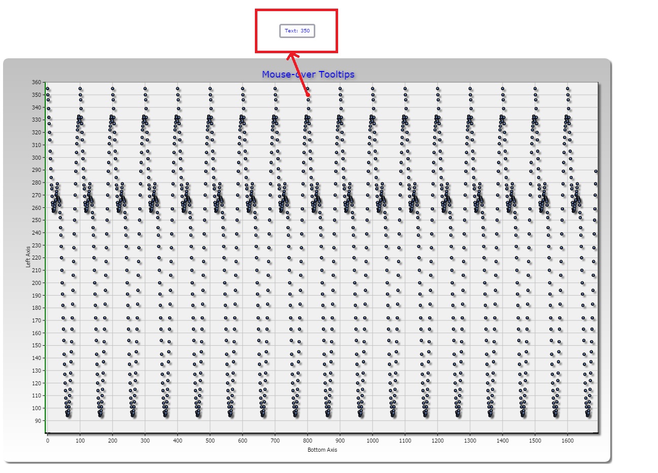

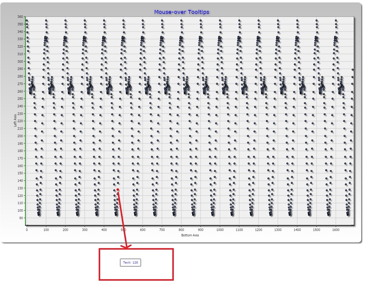

Still we are facing the tooltip traversing issue in some scenarios. If the series data values contains N no. of records, traversing issue is happening. This is not happening for the minimum amount of data's. Any insights?

Below is my sample code which is having huge amount of data's.

In some scenarios the traversing issue is happening.
